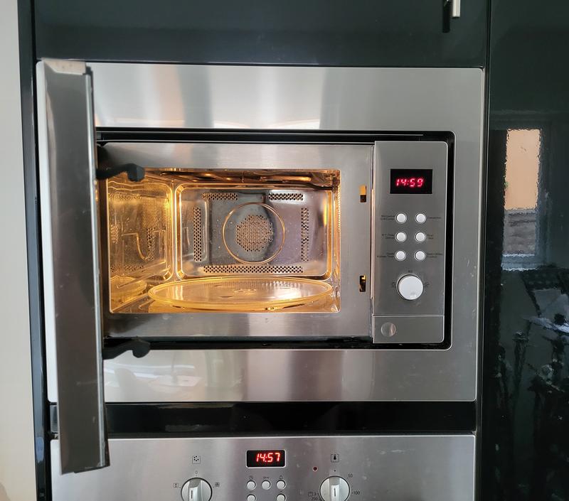

Hi guys. I need to replace my microwave which is built in above my oven. It's an old Baumatic and still works after 13 years but has had an intermittent problem for some time that is reoccurring more frequently. So it's time to get rid and buy a new one, I dunno, probably a Bosch.
My question isn't about which microwave to get but about being able to use the existing surround. Does anyone here know if or think I should I be able to install a new microwave and still be able to use the silver surround that came with the old one? I'm worried that using a new surround might not fit the space properly without faffing around with some DIY ?

Looking at your picture, I would say you have a 450mm high slot, but have a 390mm high built in microwave and what looks like a filler piece (black) between oven/microwave..
The filler strip should be removable and this is how you accomodate different height appliances within the 450mm slot when they aren't the exact height.

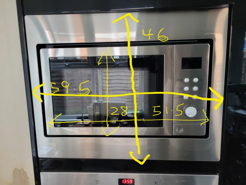

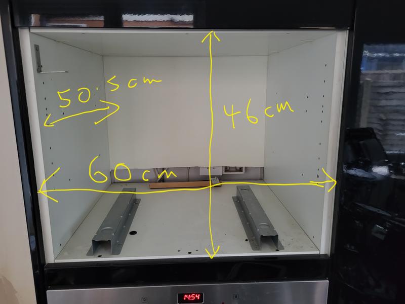

Thanks for those details. I've done some research on built in microwave ovens available and the only ones I can find that match the size of mine are a couple from Cookology, which interestingly is what your link is. Other microwaves I've looked at come quite a bit short on height. Yeah, mine is closest to the 600 x 450. Here's photos I took today with measurements.
This first picture I've marked a couple of lines showing the width and height with the trim, and a couple of lines showing the width and height of just the oven without the trim.
This second picture I've marked the width, height and depth of the cabinet recess.
It seems that Baumatic has either rebranded its name to Cookology or sold its products to Cookology, because the two £199.99 microwaves in your link (black one and silver one at the bottom, models: IMOG25LBK and IMOG25LSS) are the same machine as mine. The dimensions are the same as mine. So for the sake of less hassle and convenience I guess it might make sense just to buy one of those, basically buying the same microwave again. I might go for the black one if I do buy it just for a change, plus my cupboards are gloss black. I'd seen it as discontinued by Baumatic but it's quite fortunate the same model is still being produced as mine by/for Cookology was installed new in 2012.
