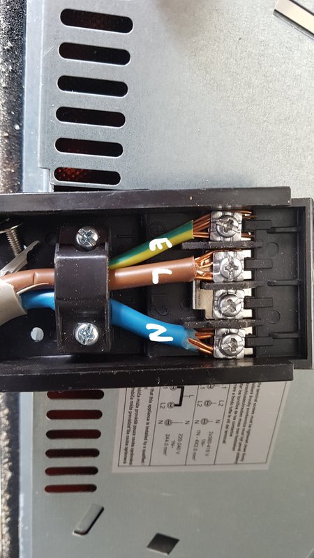

Right then, old one is out and am about to have a go and install the new one. :) I drew on the photo so I don't get it wrong.
I'm a bit stuck now. Have I done the jumpers right? I tightened the jumpers down with the screws. But where am I meant to feed the wires through? In the same holes as the jumpers?
I'm guessing I'm correct using the single phase connection?
