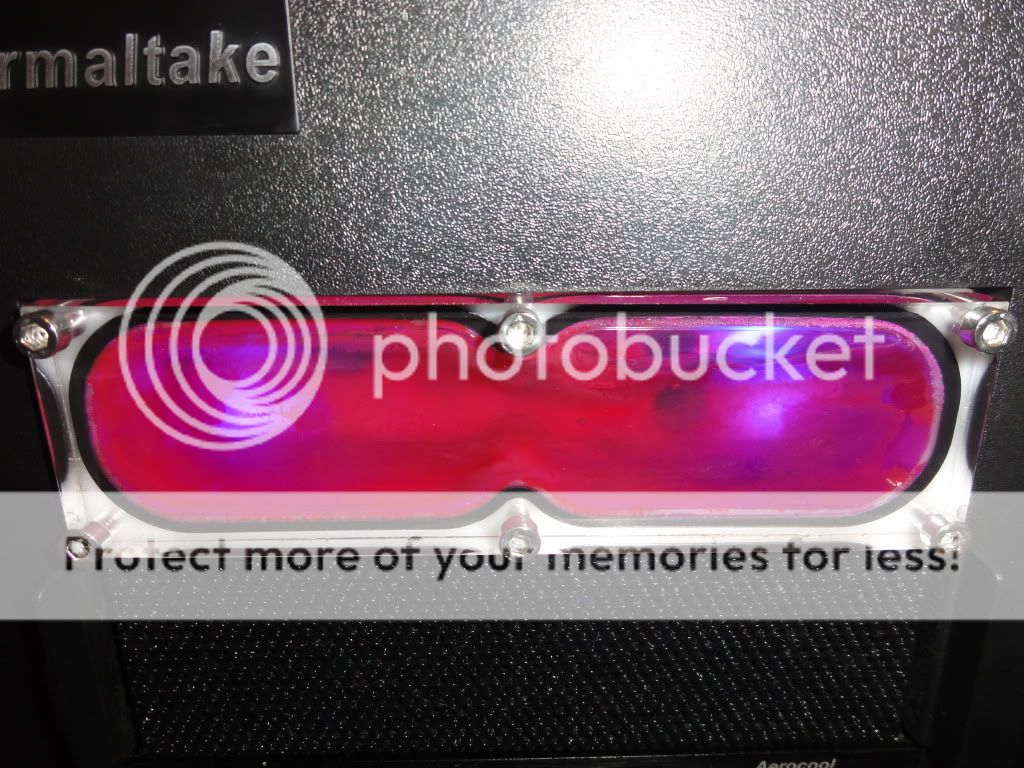

Install has only been in a week, but im getting patches on all sides of my reservoir for some reason. Im using the Mayhems blood red UV coolant, so could that be the dye??? Seems a bit patchy for dye :confused:
Any ideas?
Definitely a solid matter rather than condensation.
Will get some up tomorrow eve. Certainly looks like dye, but id expect dye to slowly cloud the sides rather than how this is. The mayhems is meant to be pretty good in both aspects of discolouration and fungal growth, hence being confuzled. Will get some pics. :)
Quite hard to photograph but:
hmm thats not normal for blood red ( it looks to pinkish in pics). we've tested the blood red for long periods of time (it does stain over time) due to it being a deep colour but it should not show any signs of braking down. Was you system new when you bought it.
Allso why type of tubing are you using if you dont mind me asking.
Everything was brand new. Tubing, res, CPU block, fittings, rad, pump.
I think the UV light makes it look bright pinky purple in person. Looks more red with lights off, but not blood red.
Its Masterkleer PVC Tubing - clear
Masterkleer does leech i will put £100 on that, as we've seen this happening may times. how ever it normally takes 4 to 5 days before you see any signs and not just a few hours.

No, it did take roughly 4-5 days. What hosing do you recommend that doesnt do this?
Will drain, flush and maybe go with a different colour. :D
Cool. Will stick to that then. Oh and it seems that most of the colour has come out of the coolant now. Will see how it looks when i drain in. Have a little of the stuff in the bottle left to check against.
Did you add any biocide at all. Because that is defiantly not normal.
X1 doesn't need any thing added as it may react with other chemicals in the loop. Its a stand alone product.
Nope, nothing added. Was going to put a kill coil in, but didnt bother as you suggested in my other thread, its pointless.
Bought some clearflex. Also got some of your Ultra Pure H20 Watercooling Fluid. Will let me see if i get any build up. The fluid will only be in there until i upgrade my graphics card so doesnt need to be pretty for now. Think ill put the kill coil in anyway this time. :p
