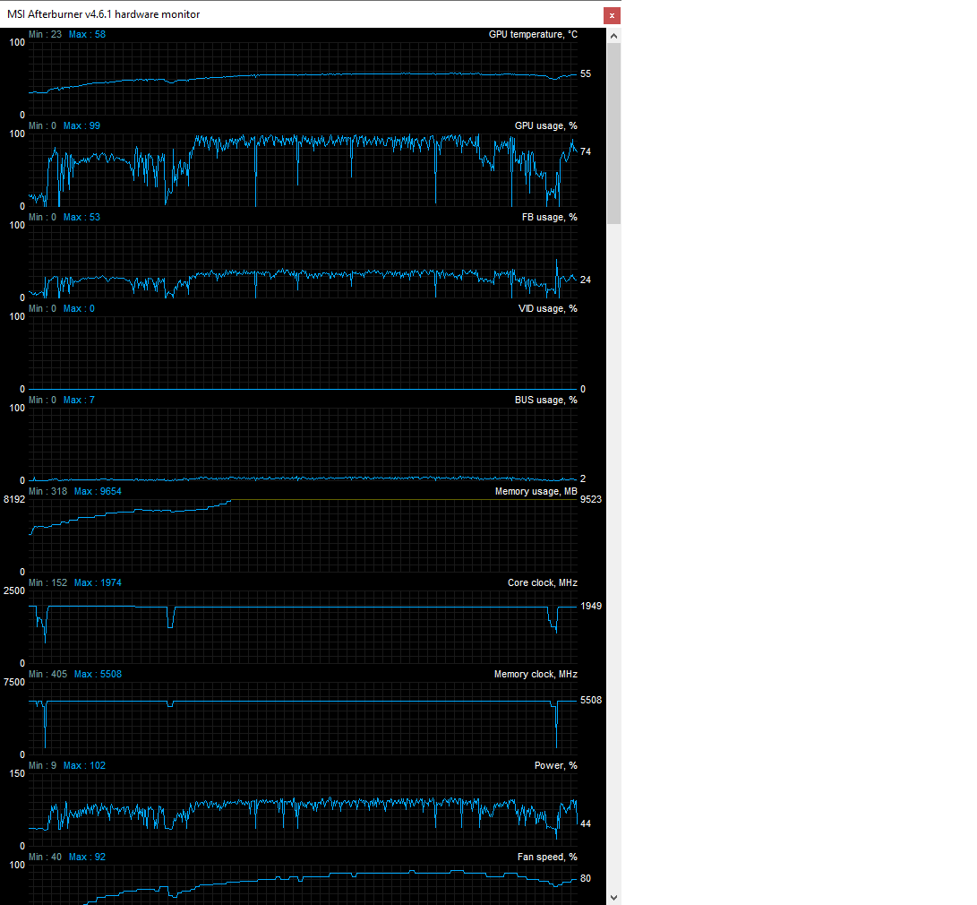

OK here are my CPU usage and GPU usage after 1 round of COD Cold War
They seem all over the place, is that normal?
If your framerate has dropped since going to a higher resolution monitor then it's almost certainly down to the GPU.
Yes, normal. Load on the GPU/CPU depends on what is happening in game at the time. The usage on your graphs actually looks very similar which suggests to me that in Warzone the CPU and GPU are well balanced against each other, with no significant bottleneck. So upgrading 1 of them in isolation probably wouldn't result in big performance gains in that game. You'd need to do both.
