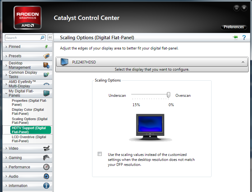

If 1920*1080 is the highest you can choose then I'm assuming you have problems with it not fitting properly to the screen. Can you see this setting in CCC?
If you play with this setting then it should be able to make the picture fit properly onto the TV.
I have looked and cannot see that setting :( and if it fits it will still be blury won't it ?
Strange, scaling options should appear up when it detects you're connected via HDMI.
Sometimes the blurriness can be affected due to the picture actually being slightly bigger than what can be displayed. A reason why they do this can be found here: http://www.engadget.com/2010/05/27/hd-101-overscan-and-why-all-tvs-do-it/
I would try again with the HTPC connected directly to the TV anyway in case it could be the home theater system affecting it.

I have tried setting to custom resolution and tried all in the list and the only one that seems to work is the 1024*768.
It says my native resolution is 1365*768 but I can't even set it to that ...
Propper blagging my head now lol.
No matter what I do. Or what ever res I select it looks crap :(
Is there any updates for drivers ext for tv's?
Also. I found overscan and that didn't do much either lol
I think I will just leave it at 1024*768 for now because I'm upgrading to a 60 full hd end of next month so that should be ok.
