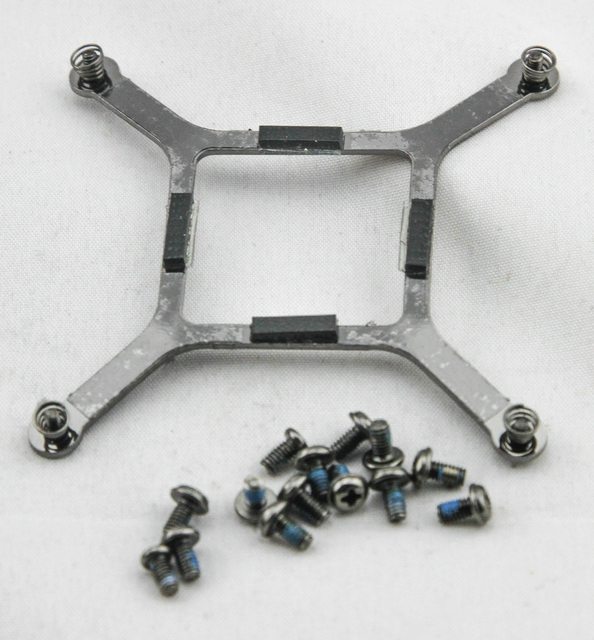

We get 8 short screws to install the bracket on to the PCB, 4 countersunk screws to install the fan shroud to the bracket, two sets of 4 standoffs (4 long, 4 short) to be used depending on the OEM of your Hydro series AIO and 4 thumbscrews to secure the AIO in place. We will get to all these in the installation section.

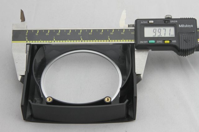

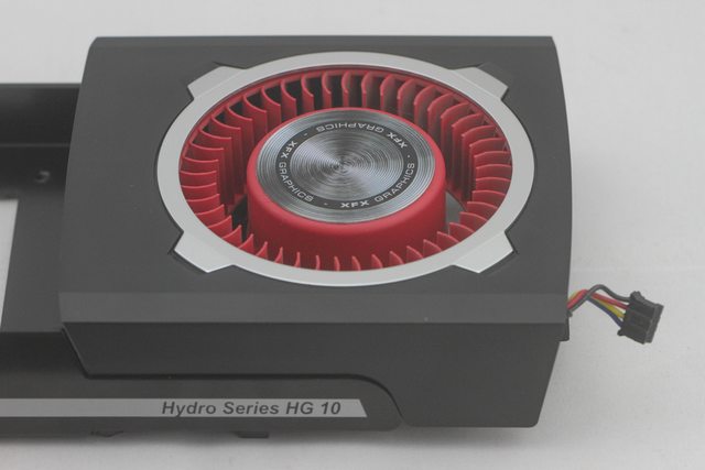

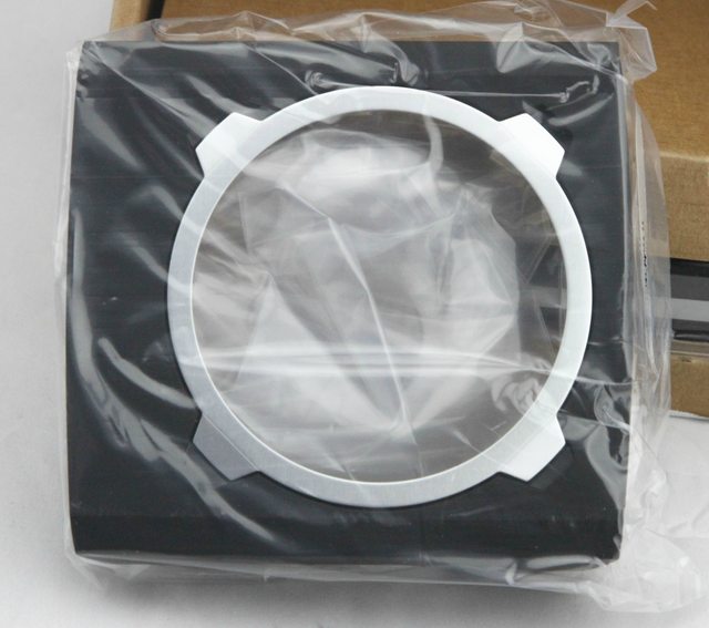

The fan shroud houses the blower fan that, in this edition anyway, has to be reused from the reference cooler. It is ~100mm wide and long from end to end.

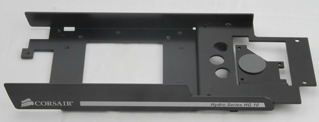

Below all these lies the bracket itself, again with a plastic cover over it.
As you can see the bracket (measured in at 9.45″ x 4″ x 2.15″) is customized for the specific AMD reference 290/290x PCB and comes with thermal pads pre-installed to fit the VRAM modules (all 16 of them) and VRMs (both sets- VRM 1 and VRM 2). The bracket has the Corsair logo and branding on either side so that it comes upright with the GPU being in regular ATX or reverse ATX format. Now let’s take a look at installation on the next page.

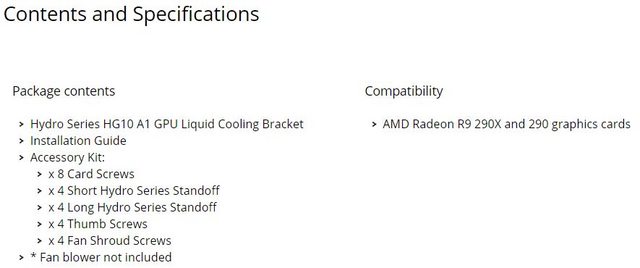

Let’s begin by taking a look at the specs courtesy the product page:
There’s also a massive list of GPUs from various AMD board partners in there but, as with all things coming out of board partners, keep in mind that there may be unadvertised changes to the components used on the PCB or even the PCB design itself which may result in the HG10 not working out as intended. The smallest things like an extra mm of height on the capacitors used on the PCB can be enough at times, and if you are not sure about your particular GPU then please do talk to both Corsair as well as your GPU manufacturer to get more information. With that being said, let’s now take a good look at the HG10 A1 on the next page.

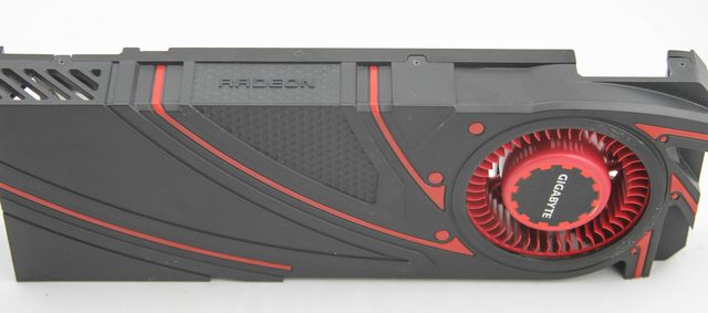

Unplug the fan header cable and you have the bare PCB and the reference cooler separate. Clean the core with some IPA (Isopropyl alcohol) and transfer any thermal pads remaining on the PCB over to the cooler itself. You may have to clean the VRMs and VRAM modules with IPA if you notice any leftover thermal pad material. Now remove the small screws on either side of the reference cooler to take the shroud off:

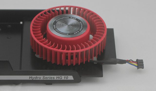

But back to installation! Remember those 3 screws I told you to hold onto? If you have managed to strip the head off them, then the screws on the side of the reference cooler can also be used here. You need to take them and screw the fan onto the HG10 bracket:

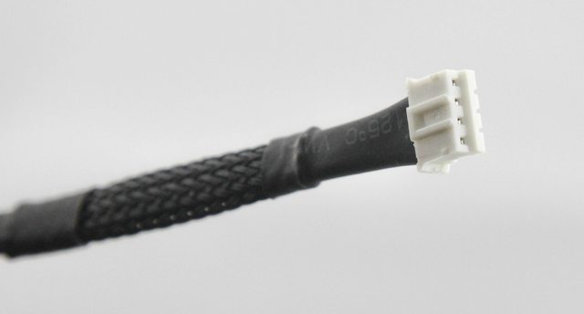

Do a test fit now to make sure the fan cable is long enough to reach the header on the PCB. If not, you can orient the fan so the cable comes off the front itself to get more room:
The fan shroud has a cutout to route the cable if you go this way:

Use the provided small screws (there should be 8 of them) that look like these:
and secure the bracket by screwing them in from the back of the PCB:
Do not overtighten the screws, the bracket is designed to allow for some tolerance but best to stop when you meet some resistance to any motion of the screw. Despite that, I did notice there was some warping of the PCB here:

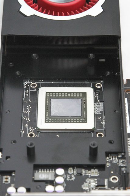

Not a very good job here either. In fact, a larger GPU die may well extend outside of the TIM here so this is why I always recommend to apply TIM yourself on a GPU die irrespective of if you are using an AIO with pre-installed TIM (clean it all off) or not.

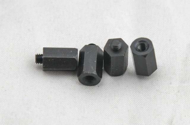

What if you have/want to use the AMD bracket? Then the standoffs go here:
That set of two standoffs near the fan shroud are not very easy to install, even with small fingers. The shroud extends inwards into the PCB at the top and so you have to maneuver around it. But that’s not the hardest part either! Assuming you have the AMD bracket installed already:
It is very hard to get the two standoffs near the fan installed at all, let alone correctly. You would be risking possible uneven TIM spreads here, and this is why I recommend going with the Intel bracket if you have it- at least with the HG10 A1. Corsair tells me that the newer brackets will account for this and will make it easier to install the cooler with either mounting bracket.

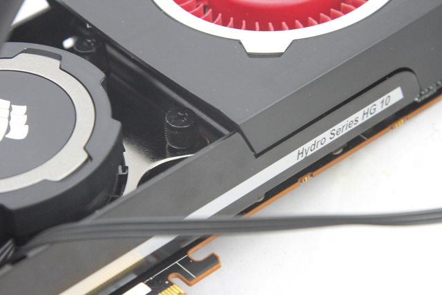

At this point, you would be generally done with the installation process (as long as you know how to use the particular AIO you have ready, anyway) but I wanted to show you this:
Again, it could be a result of this particular PCB but you can see that the VRM 1 thermal pad makes non-uniform contact across the length of the pad. If you see something like this, fret not- even this slightest of contact is enough with these stock pads that ended up performing well. The stock pads that come with the HG10 A1 have a rated thermal conductivity of 1 w/mK but the thickness (or lack of, rather) means that this doesn’t play a big role here. In fact, a quick test with some 11 w/mK rated thermal pads resulted in VRM 1 temps being just 0.4 ºC better on average with the blower fan at 50%. Based on my findings with the HG10 A1, I don’t recommend swapping over thermal pads.

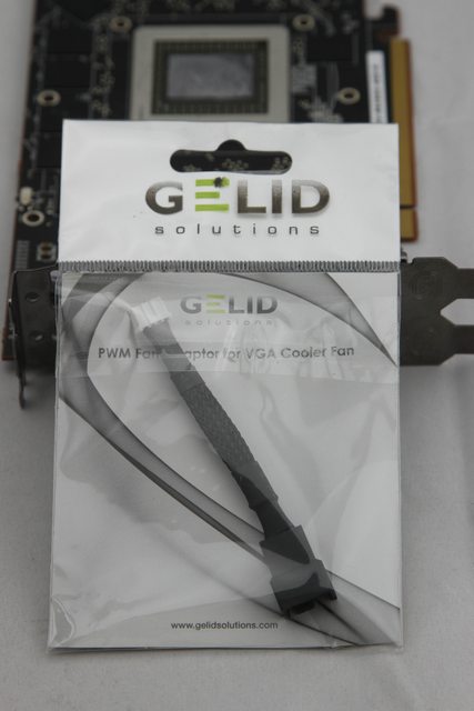

If you have lasted this long on this page, then I thank you. I have one more piece of information that may prove useful here and it begins with this:

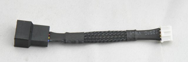

This is a Gelid PWM adapter to be able to use any standard 4 pin PWM fan with the GPU fan header on PCBs (which is also a PWM header but in a smaller form factor) as you can see from the two ends of this adapter:
Why did I bring this up here? Back when the HG10 was launched (the A1 is the first HG10 variant), the reasoning behind the re-use of the stock blower fan from the reference cooler was given as the GPU BIOS and the fan header designed to work best with that fan. To be fair, it does make sense but what about the whole part where we can set custom fan curves anyway? Will this adapter help prove their point in that one can’t just take any fan out there and use the GPU fan header to control it effectively? Let’s find out on the next page along with how the bracket performed thermally.

Brand new AIOs come with pre-installed TIM on the cold plate which is really a one size fits all type of solution for CPUs themselves and don’t necessarily do a great job there. What about a bare GPU die?

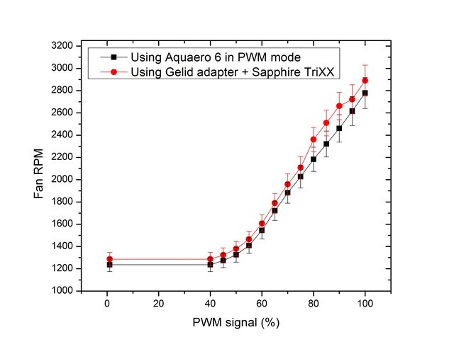

I hooked up a standard PWM fan, the stock PWM fan from the Silverstone AR02 CPU cooler to be specific, to both the GPU header using the Gelid adapter like so:
and also to an Aquacomputer Aquaero 6 XT fan controller in PWM mode. In the former case, I used a universal waterblock on the GPU core and some heatsinks on the VRMs with active airflow over them to make sure that I could install the GPU (with the fan still hooked to the GPU fan header as above) on a z97 test rig and used Sapphire TriXX (version 4.8.6) to control the fan speed manually and GPU-Z (version 0.8.1) to monitor the fan RPM. In the latter case, the Aquaero itself provided fan RPM readouts. So how did the two methods work?
Both methods gave very similar results, and within a 5% margin of confidence there is nothing really to distinguish between them. So re-using the stock blower fan really is now only if the end user is expected to stick to the automatic fan curve and nothing else. But that’s also a folly in my opinion- the fan curves in the GPU BIOS are set to respond to the GPU core temperature and the HG10 A1 makes it so that the blower fan really is only to cool the VRAM and VRMs. Depending on the core temperature, which is going to be definitely cooler with an AIO relative to the reference cooler, will result in the blower fan being at minimum or near minimum speeds the whole time depending on the particular fan curve and for the wrong reasons. Sure, even minimum speeds may be quite sufficient here but give the end user the benefit of doubt here- if he/she is getting this to use in a system then it is very likely that the person also knows how to set a custom curve or manually control the fan.

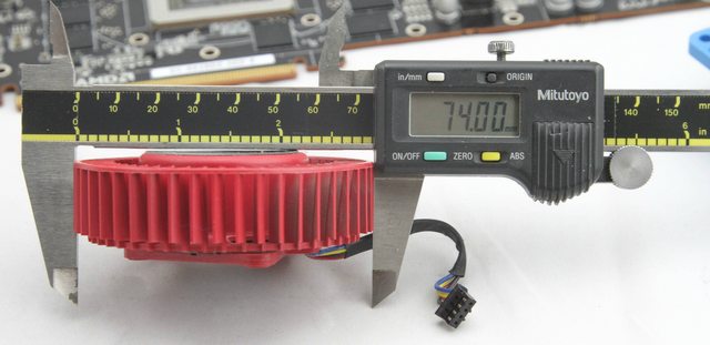

The stock blower fan is just ~74mm in diameter compared to the fan shroud that measured in at ~100mm from end to end and can easily fit in a much larger fan too while also increasing compatibility with a lot more GPU SKUs (the ones that re-use the reference PCB but with a 3rd party air cooler, for instance). With Corsair having experience in designing case and radiator fans too, I found it slightly disappointing that they took this route. But I am happy to say that the HG10 A1 is the first and ONLY variant to rely on the reference fan from AMD and every HG10 coming henceforth, beginning with the N1, will come with a Corsair blower fan that is pre-installed in the bracket along with the shroud to further cut down on the installation process. The new blower fan has been optimized to fit the shroud better and has a PWM duty cycle + RPM response curve optimized so that they provide cooling to the VRMs even with the core temperature being low, while still being relatively quiet. While this does not affect my review of the HG10 A1, I am glad they have taken all the lessons learnt from making the A1 and adopted it into the future brackets.

What I do fault them for is going with the re-use of the reference blower fan. I have covered this on pages 3 and 4 in detail, and I will again let people know that Corsair is including their own customized blower fan on every HG10 variant beginning with the N1 but it does not affect the A1 in any way so this review will continue to have this little sour note.
