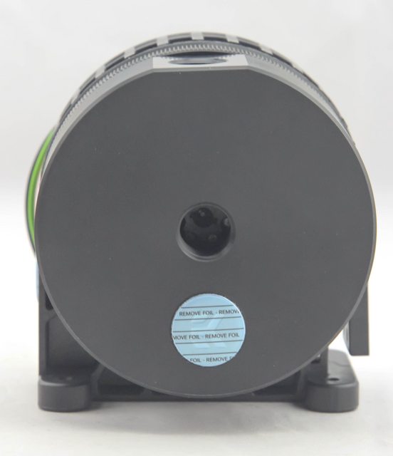

A reminder that EK makes other products also, and then we get to the meat of things. The pump itself pre-assembled, and the optional rubber damper is bundled in with recently purchased pumps and henceforth. This damper has rubber pyramids, if you will, that hold the pump in place and do a good job dampening down any vibrations from the pump to the case or vice versa. The stock damper comes pre-installed, and we will take a look at that soon.
The pump comes in a plastic sheet with an EK seal on it, for further reassurance that you are getting a new product and also to keep any dust outside. Let’s remove the plastic now:
It’s a cute little thing if I say so myself. Coming in at 68.5 x 91.5 x 78 mm (LxBxH), it is a lot easier to fit in compared to most other standalone D5 pump setups. This has a tradeoff though- there is a single dedicated inlet and outlet port each whereas many aftermarket D5 pump tops offer options for one or both. Both ports were threaded perfectly and follow the de facto BSP G1/4″ standard as can be seen above. There are also 3 EK badges on this, with a protective cover to be peeled off as desired. To give a visual comparison with other tops/body covers, let’s take a look at the XTOP Revo D5 in the middle with the stock Laing D5 pump top on the left and the EK XTOP D5 clean plexi w/black cover on the right:
This is why I was saying that the XTOP Revo Plexi would have been better to do a like to like comparison with its predecessor, the XTOP D5 clean plexi top. Also, while not a direct comparison, here’s how the clean plexi top w/pump cover looks next to the Bitspower mod top and cover for the D5:
So we can see that the new XTOP Revo is smaller in most dimensions, has mounting a lot closer to the pump body and also occupies a smaller footprint, has a functional body cover as opposed to a purely aesthetic one, and has no optional inlet or outlet ports. Let’s take the pump top off:
The volute is similar in design to a lot of other D5 tops I have seen, but has subtle changes where the outlet neck is located- even compared to the older design:
So there may well be a slight performance change also here. What about the rest of the unit?
The pump innards are no different than a standard D5, and no complaints here. The magnetic rotor and the ceramic bearing are tried and tested, and performance at 12 V and full speed is no different than any other 12 V D5 in the same ~4500-4800 RPM range. Unsleeved PWM cable and full size The new thing here is the rubber damper and holder, and the “older” one is pre-installed out of the box. The holder is like an open clip which secures in via 2 screws on one side, and this is where the M3x12 screws come in. Once you are ready to screw this into a case, be sure to screw the holder as well. Open it to help release the pump and change the damper if need be. Speaking of which, let’s take a look at the new damper vs the older one:
The new damper is supposed to have a slightly worse grip on the pump, and less contact with the holder, but provides more vibration dampening. This is also the recommended damper if you are using the pump vertically as described in the manual. Just be sure to have the pyramids on the surface sticking up and towards the locking nut:
Do note, however, that it is best to use the regular/old damper if shipping a PC with this pump so you have the best grip on the pump and it does not loosen. The XTOP Revo can be used without the holder or damper, as the O-ring and the locking nut are all you need to secure the pump top in place:
This is useful if you are hooking up the pump to a reservoir directly via fittings, but in case you are concerned about the dead weight it is also possible to use the EK-UNI pump bracket for a 120 mm fan horizontal (140 mm version is in the plans too):
or the EK-UNI pump bracket (120 mm fan) vertical:
Whatever method of installation you choose, just make sure the inlet port is not upside down and coolant entering the pump is not fighting mavity. That’s basically it! Let’s take a look at how the pump top and the new PWM G2 pump perform.
