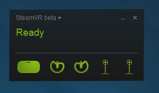

Start Steam VR from the icon on the top right of the Steam window. Don't put your headset on but you should have a little popup that looks like this:
Click the little arrow next to where it says Steam VR beta on that panel and then click Run Room Setup. Follow the directions.
