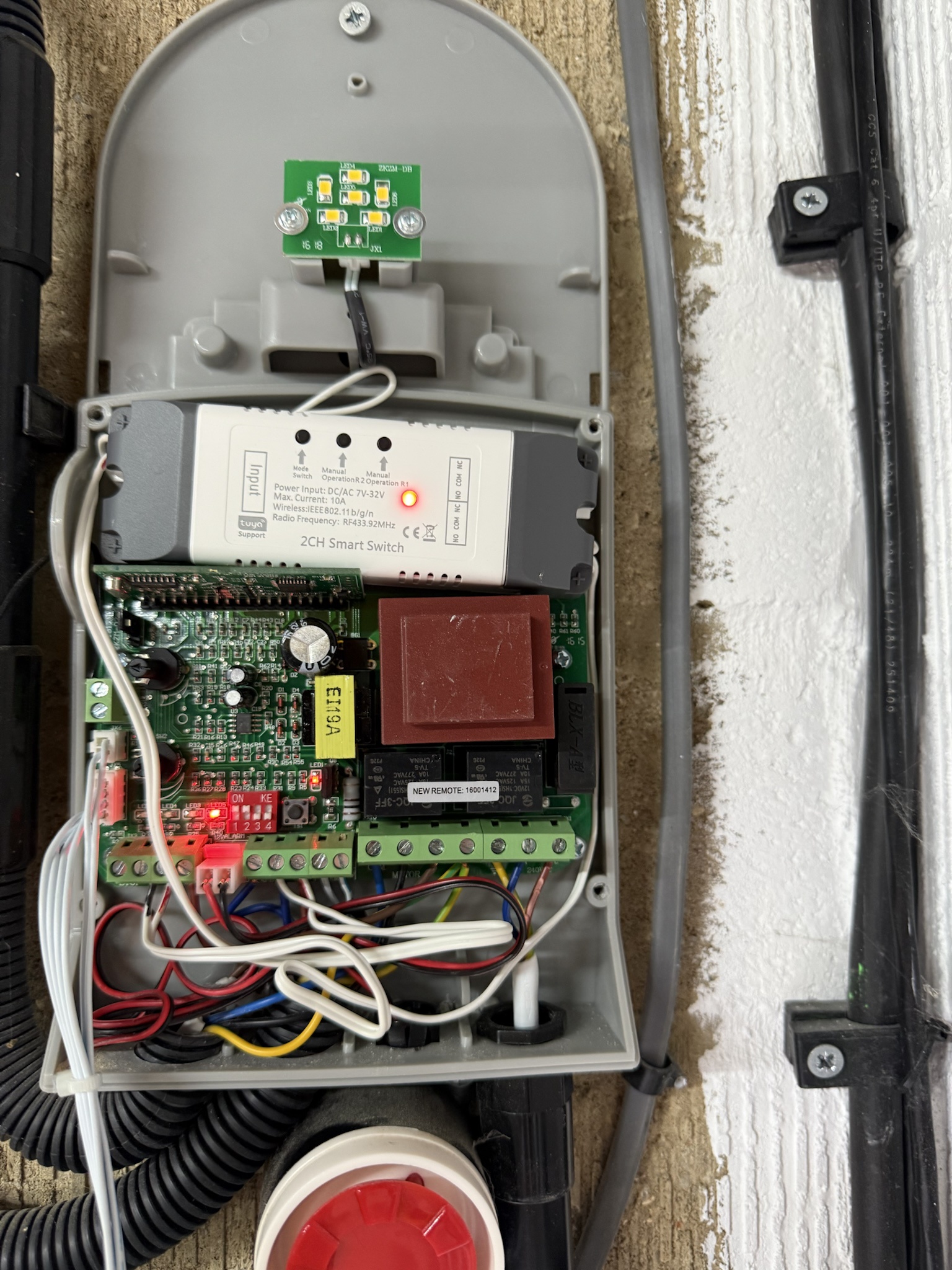

I’ve currently got two doors controlled by NECO controllers, specifically these:
I’m looking at options to replace it with something ‘smarter’ or add smart functionality to this controller.
Even if I stick with the NECO units, I’m looking to replace at least one controller as it’s a bit flakey sometimes (just doesn’t respond to the remotes, turn or off and on or come back 10 mins later it works fine). The remotes are not very good quality either.
I’m about to order my 3rd set in 5 years because either the open or the close button has stopped working. For one door I am using one remote for open and another for close, as I don’t have two remotes with all working buttons! :cry:

NECO controllers have a Tuya smart controller which you can add on that seems to integrate with my existing units and there is a Tuya integration for home assistant. This is probably the cheapest option.
The other option seems to be using a Meross smart controller and a compatible door controller. This one will cover both doors:

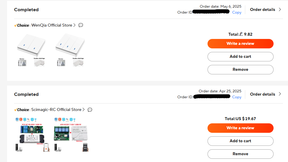

OK I just had a look at my Ali account ...
I bought a 2ch and a 4ch relay for a total of 19 US dollars (always pay in dollars it's cheaper than in GBP)
Thing to look out for is the input - both can be set up and powered with micro usb - for setup this is practical for application deployment not so.
Therefore you have to check how you want them powered - for the 2ch I opted for 240V mains as I was basically converting a single outdoor floodlight into 2 smart floodlights. The 4ch is in the shed so wanted DC input for that
NOW here's the brucie bonus - You can pair ANY 433mhz remote or switch to the relay which is done through the Tuya app
So in my 2ch application I bought a nice looking 433 touch switch (12-13 squid off the bay I think) that I paired and simply stuck to the kitchen wall so you got some sort of manual control
EDIT : Final edit - The relays were finally added to Home assistant via local Tuya so no need for internet
I'm not sure if direct links are possible but here's a sample of what I bought
Make sure you buy the housing for the relays - it's slightly more expensive but worth it
The switches above also work but a nicer one is this

Is this it?
Yup but buy with the housing, don't just buy the board
Great, thank you!
I may get 2X 2 channel units for a cleaner install as the controllers are on opposite sides of the garage but that’s £40 saved per door!

The NECO branded units have the 7-32V DC input, I’ll double check my controller actually has that available before I order otherwise I’ll get AC.

Looking at the working diagram, in theory, the Tuya switches I ordered should work.
