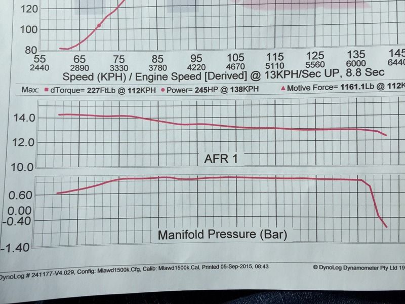

Spot on the obvious problem (Evo 8 FQ-300)!
Induction kit to blame? Can't go above 6000rpm or I could melt a piston! :(

He did have a clue, he said it was running crazy lean, it should be just below 12 on the graph. He asked if I had my standard air box so he could swap it back in to see if it made a difference but I never had it with me.

I wouldn't be go anywhere near 6k with it running like that, if anything I wouldn't be going anywhere near boost at all. I wouldn't be surprised at all if the engine was close to destruction through detonation already, 14:AFR on boost onset is not good (closer to 12.5:1 is "normal")
My MX5 is richer than that with no boost yet

I'm convinced he thought it was the induction kit because he wanted to test it again with the standard air box. It was a rolling road day a guy I know organised and it was £35 for 2 power runs measuring boost etc.
Frozen, it's pretty hard to stay away from boost as my turbo is small and spools quickly. Boost is sitting at 1.1 bar. The AFR should be sitting roughly at 12.

Did he check AFRs at idle/cruise at all? If it was fuel pump/injector related I'd expect AFRs to lean out as RPM/Load increase as additional duty on injectors/required fuel flow would put exaggerate an issue there.

That was through the rev range, uses the rpm from the graph above.
It's a HKS induction kit (that I want to change for an A'PEXi anyway) and the MAF sits in the cast you get with the induction kit. It's totally possible the MAF is dirty as the HKS has poor filtration but a dirty MAF shouldn't cause this or could it?
I know that's through the rev range but that's only WOT did he check it at part throttle at all?
Dirty MAF would cause misfuelling but not to this extent.
But as you say the HKS kit comes with a different cast for the MAF that will more than likely be the cause. The different diameter means the airflow the MAF is reading and the actual airflow through the MAF are two different things.
