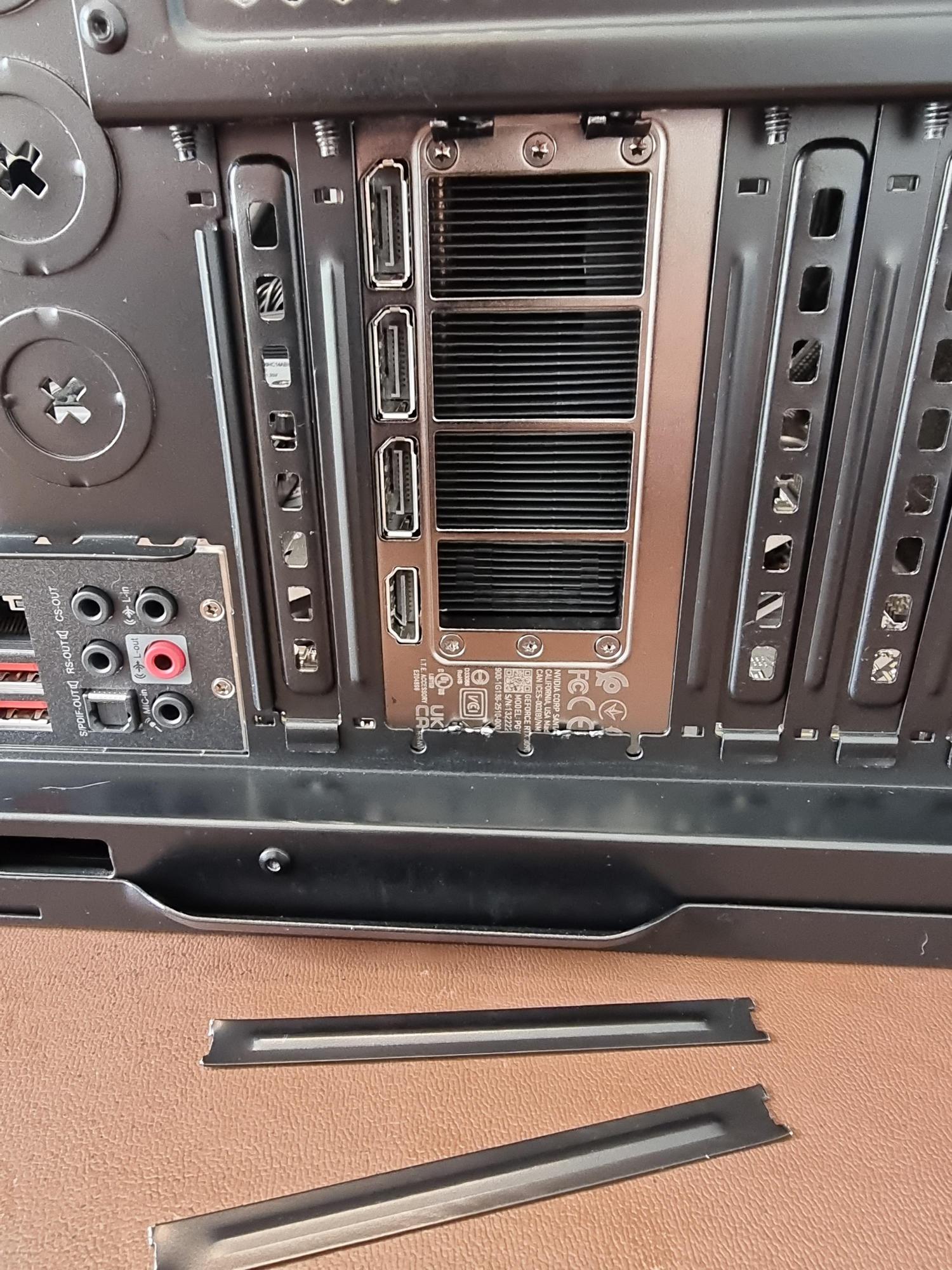

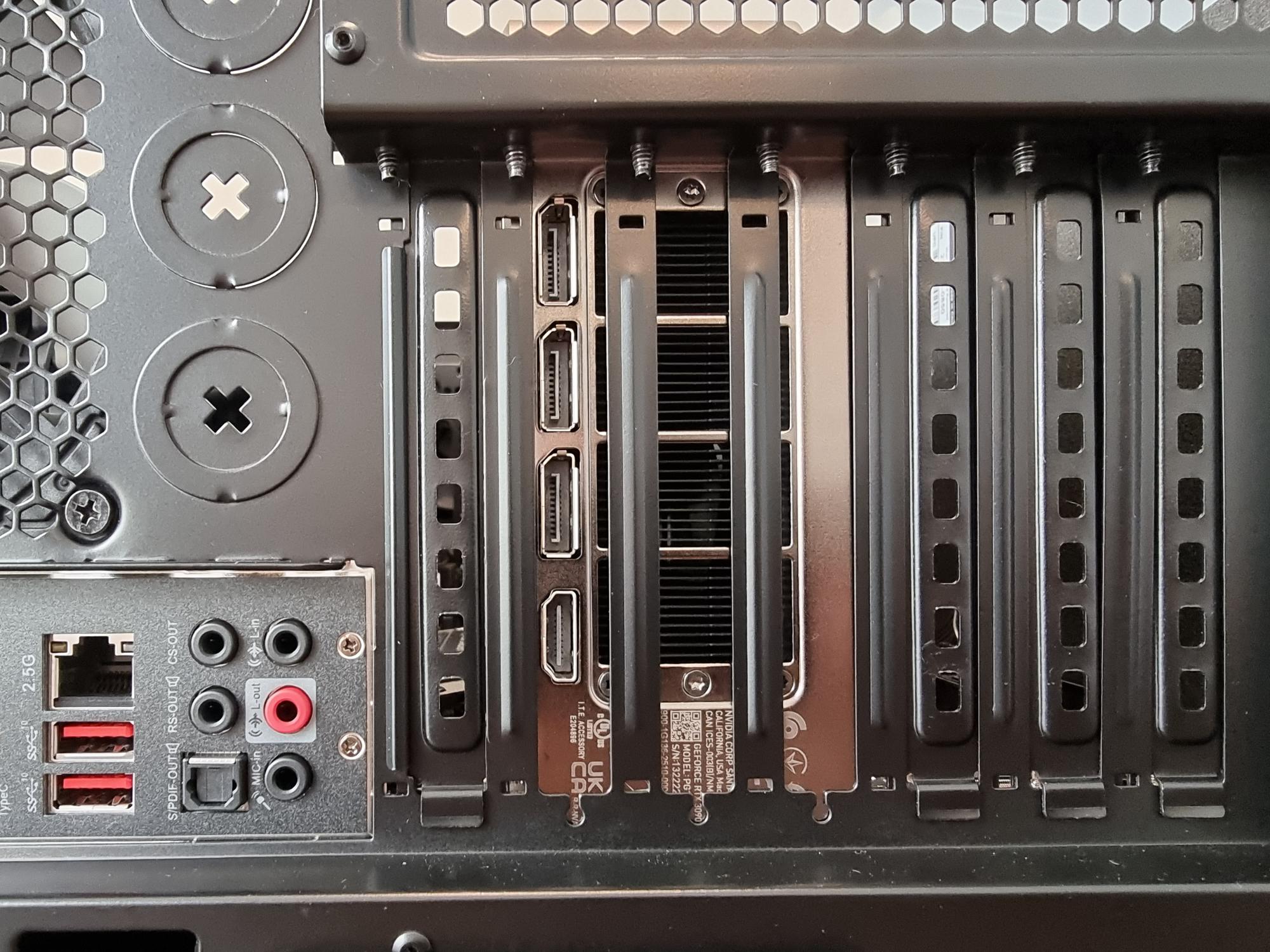

I managed to bag a 3090fe, delivered yesterday.
And I'd not actually thought through how the cards thermals worked until I installed the card and realised the my PC case's metal structure blocked about 50% of the 3090's rear exhaust.
I've ended up snipping two metal braces off my case to allow the 3090 to breathe correctly.
I wonder how many others this affects?
Jobs a fish :D
@FlyingFish
Yep, rookie error if any 3090FE owner’s not done this yet. Mine’s been like that since last year.
Typical gaming temps of about 65C and mid 80’s on the VRAM. Can’t say that I’ve tried mining though…
@FlyingFish
That vram temp is good, what sort of fan curve are you running? Have you done the thermal pads? Mine peaks at 96C from what I've seen, and that's running ray traced games at high settings.
