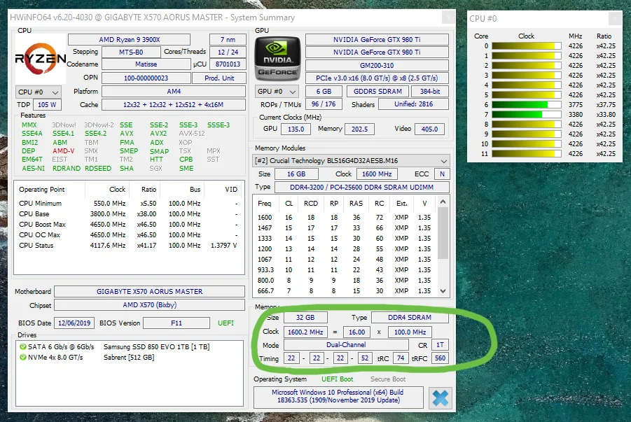

Thats better,you might be able to lower trfc aswell now,andmaybe try 22 timings just keep.lowering a bit at a time till you reach minimum stable ect
Thanks, I'll have to look at that. Sooner or later I will.
I tried dropping the memory down to 3200 just to see what effect that has on the latency (24 to 22).

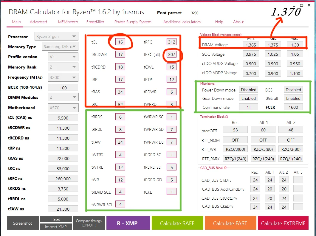

I finally got around to applying most of the 1usmus dram calculator settings. Upon restart I was greeted with a black screen so I'll have to take another look.
These are the settings for my memory according to the calculator. The green boxes, I had no issues with the settings when entering them.
With the smaller red box on the right, although probably a minor thing, I noticed that I'm only allowed to add/decrease voltage in increments of 10 (e.g. 1.360 or 1.370 but not 1.365v).
The large red box with circles in denotes that I couldn't find tCL in the bios and tRFC (alt) indicates that there were two additional options in the bios, so I just left them as they were. All I did was change the one above (tRFC).

I've noticed that when you import your RAM's data from thaiphoon burner the settings that the DRAM calculator gives you is different, maybe worth trying?
Hey, thanks for the reply. :)
Do you mean use the thaiphoon settings as opposed to the ones by 1usmus?
Btw, I can't remember if PBO should be enabled? Mine's on auto at the mo.
^^ ... or global C-state control?
You use Taiphoon Burner to read your RAM's data, then you export it to an HTML file iirc and then import that into the DRAM calculator, it gives a much more precise reading of what you should be using rather than guessing so to speak, I'll see if I can get the steps needed in a moment :)
This is what I used:
PSA: Use Thaiphoon to export/import your XMP profile into DRAM Calculator rather than clicking R-XMP button.
Open Thaiphoon, click Report button.
Scroll all the way to the bottom.
Click 'Show delays in nanoseconds'
Export, Complete HTML Report, Save.
Click Import XMP button in DRAM Calc.
Navigate to your saved HTML Report.
@arc@css
You need yo check the advanced tab to find what RAM quality you have.
  1. Import profile from Taiphoon Burner
  2. Click the Calculate FAST button
  3. Click on advanced tab
  4. At the bottom left you will see your RAM quality.
If it is less than 90% you need to go back to the main page and select V2 for Profile Version (3rd option down on left column). That will calculate looser timings based on the lower quality RAM. If it still doesn't work calculate the SAFE settings and use them.

Also with applying loads of RAM settings, you may have to reboot manually as some settings need to be loaded before others. Mine hangs and I have to cycle the power button (once presented with a black screen) and then it will load and change other settings. So black screen may just require you to cycle the power and the BIOS learning/setting on the MOBO. SO if presented with a black screen maybe cycle the power first. Good luck.
