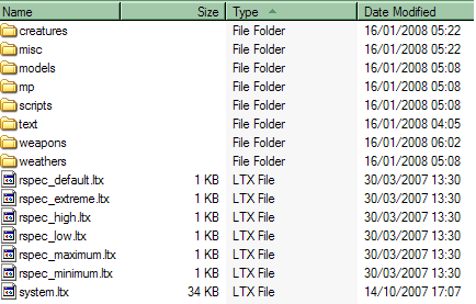

If it will help heres a list of the contents of the gamedata\config folder before & after I applied the mod. Am I messing something up? As you can see the mod added a lot more stuff!
gamedata\config before Faiakes Mod v2.4
gamedata\config AFTER Faiakes Mod v2.4
