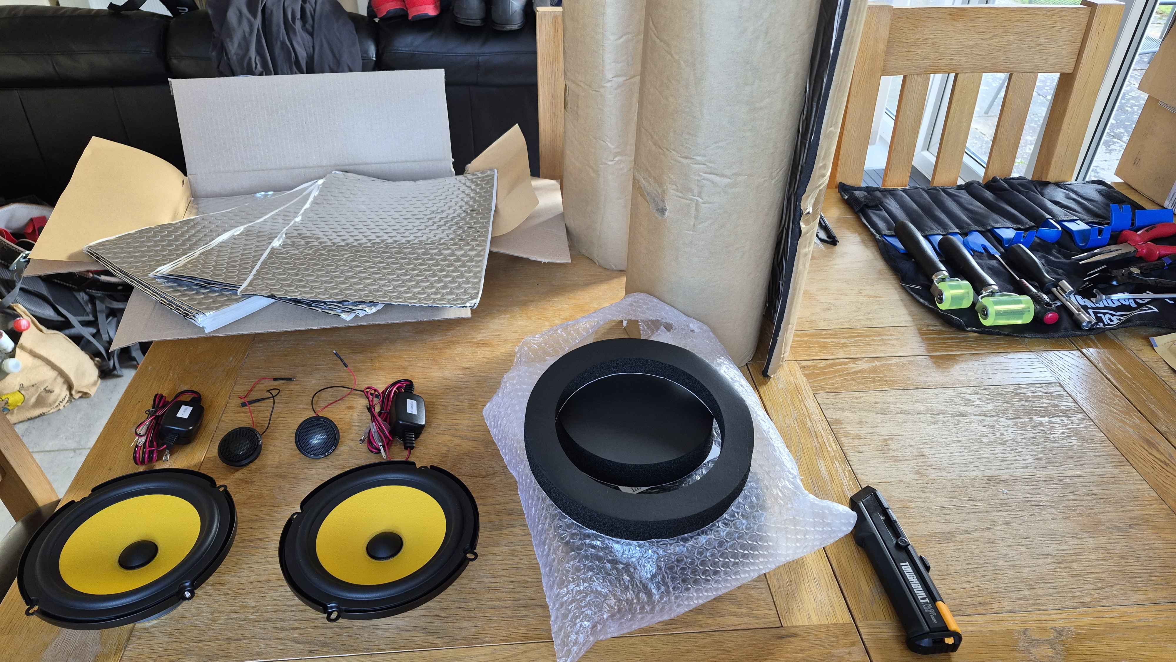

So I had the bright idea of.... initially... replacing the front speakers because one had blown. So I figured "may as well just upgrade them while I'm at it"..... This turned into sound damping, upgrading every speaker, amp, and sub...... I have a problem :( Learned a lot during the process though... namely, car audio is expensive - and Ford are actual ******** for integrating data signals into every single thing, even when it in NO POSSIBLE WAY needs it.... Will stick a parts list at the bottom for anyone who makes it that far.
1. Take basic ass Mustang
2. Take some basic upgrade parts (Front Component speakers and sound deadening/damping)

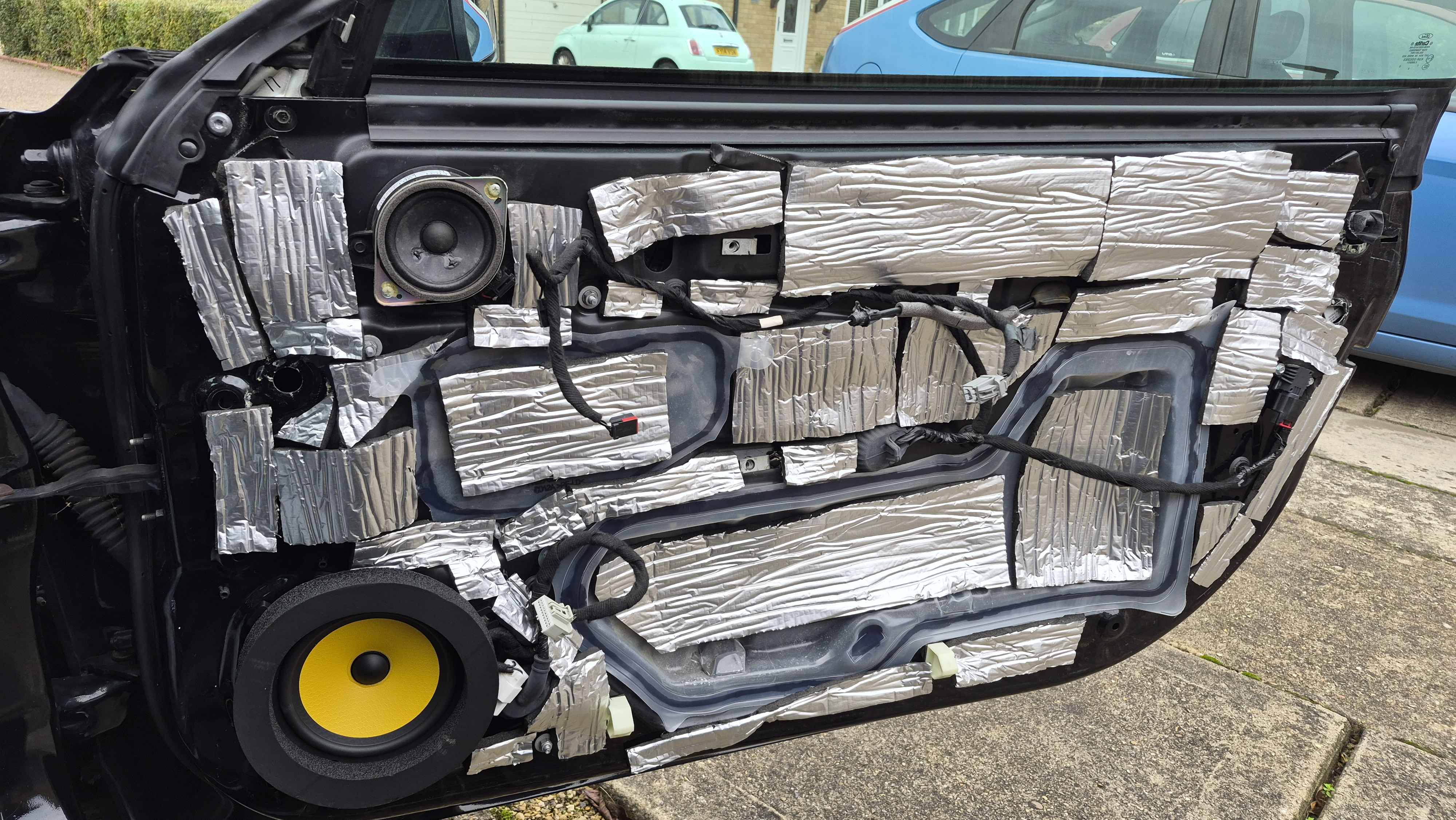

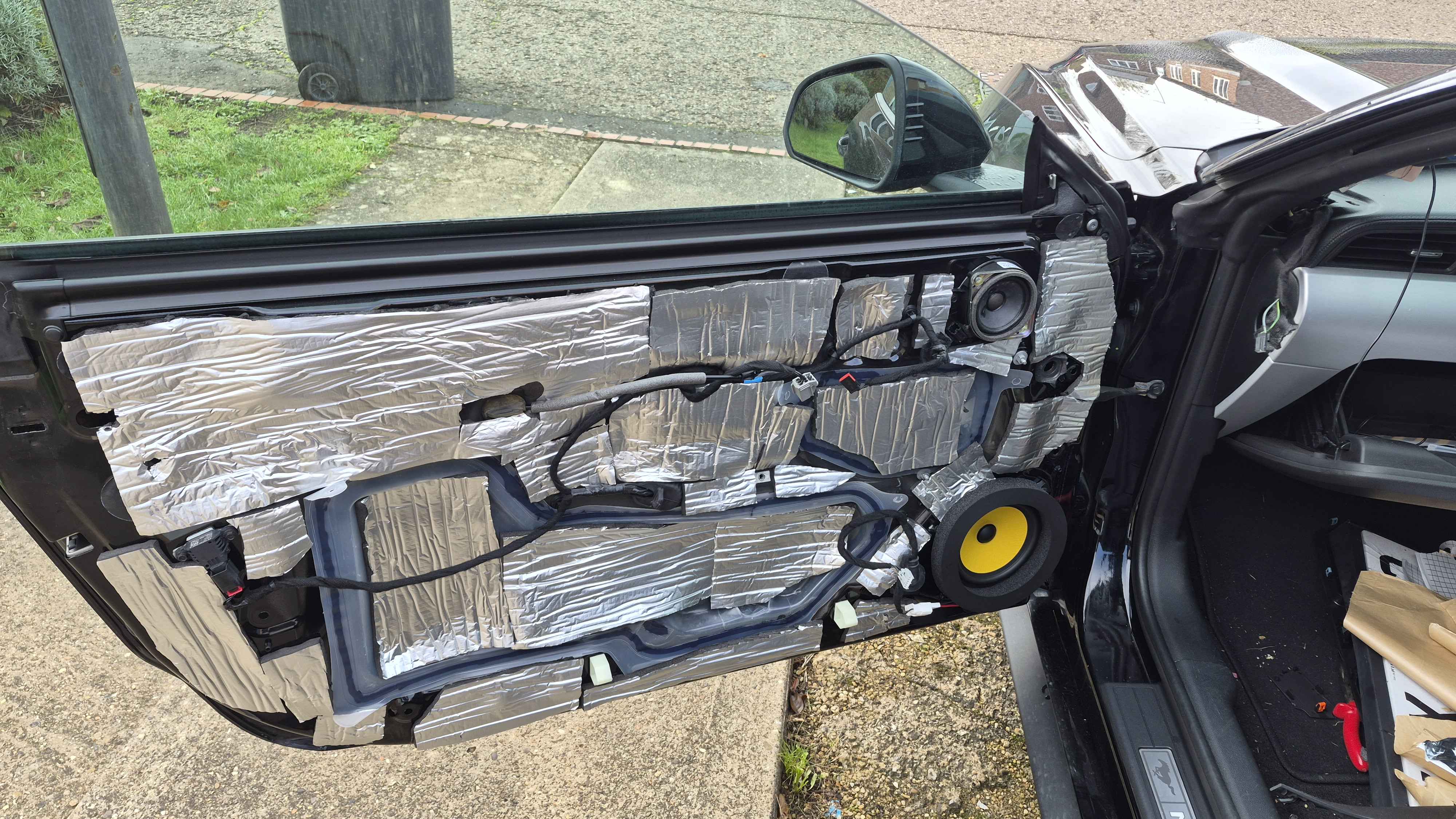

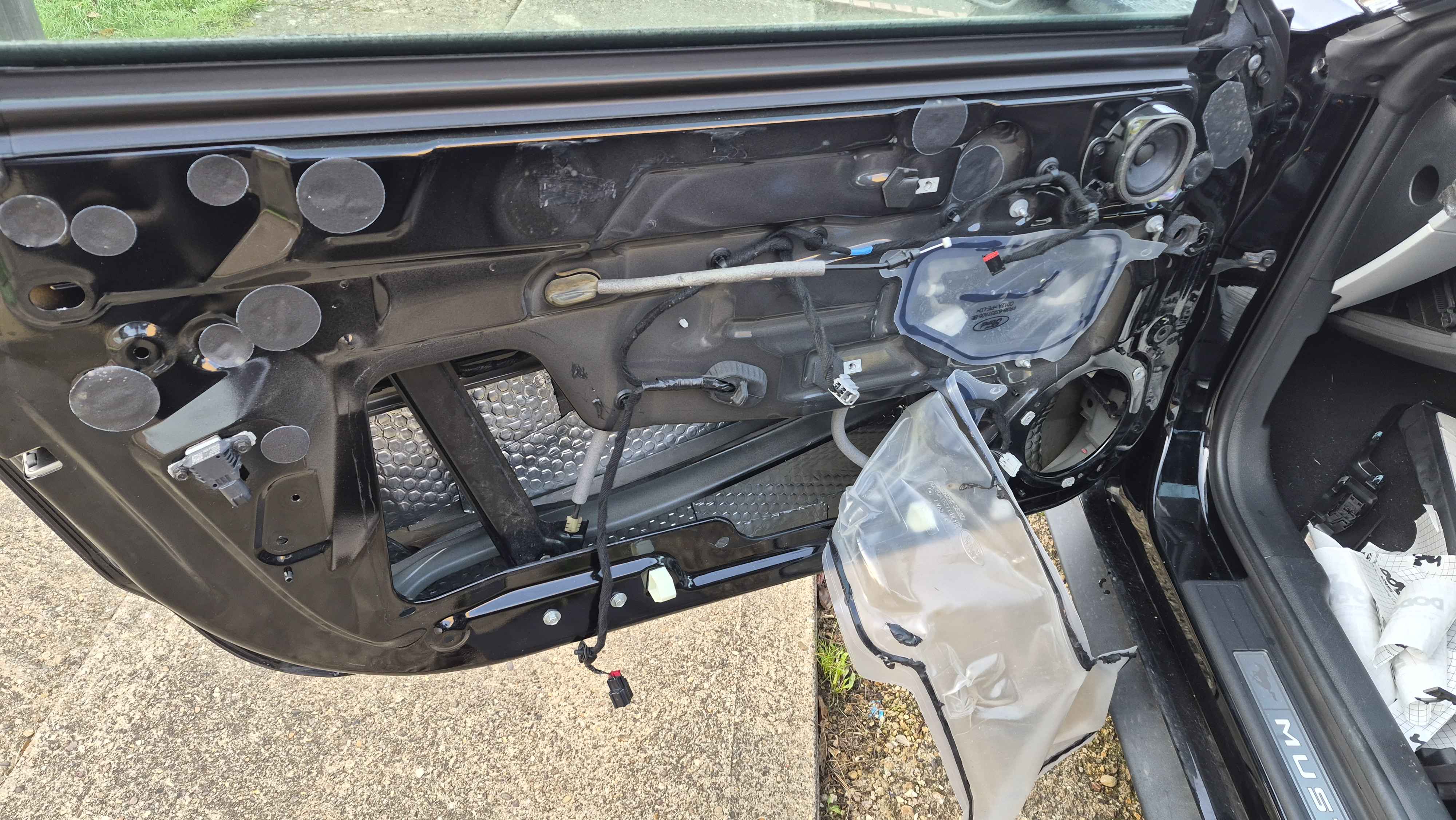

3. Strip doors and put in Deadening material on external panels (outer skin of the doors) and replace speakers
I overshot the foam insulation on this one... and working with large pieces to try and cut holes out the middle was a real pain in the ass... so the next door I used smaller pieces

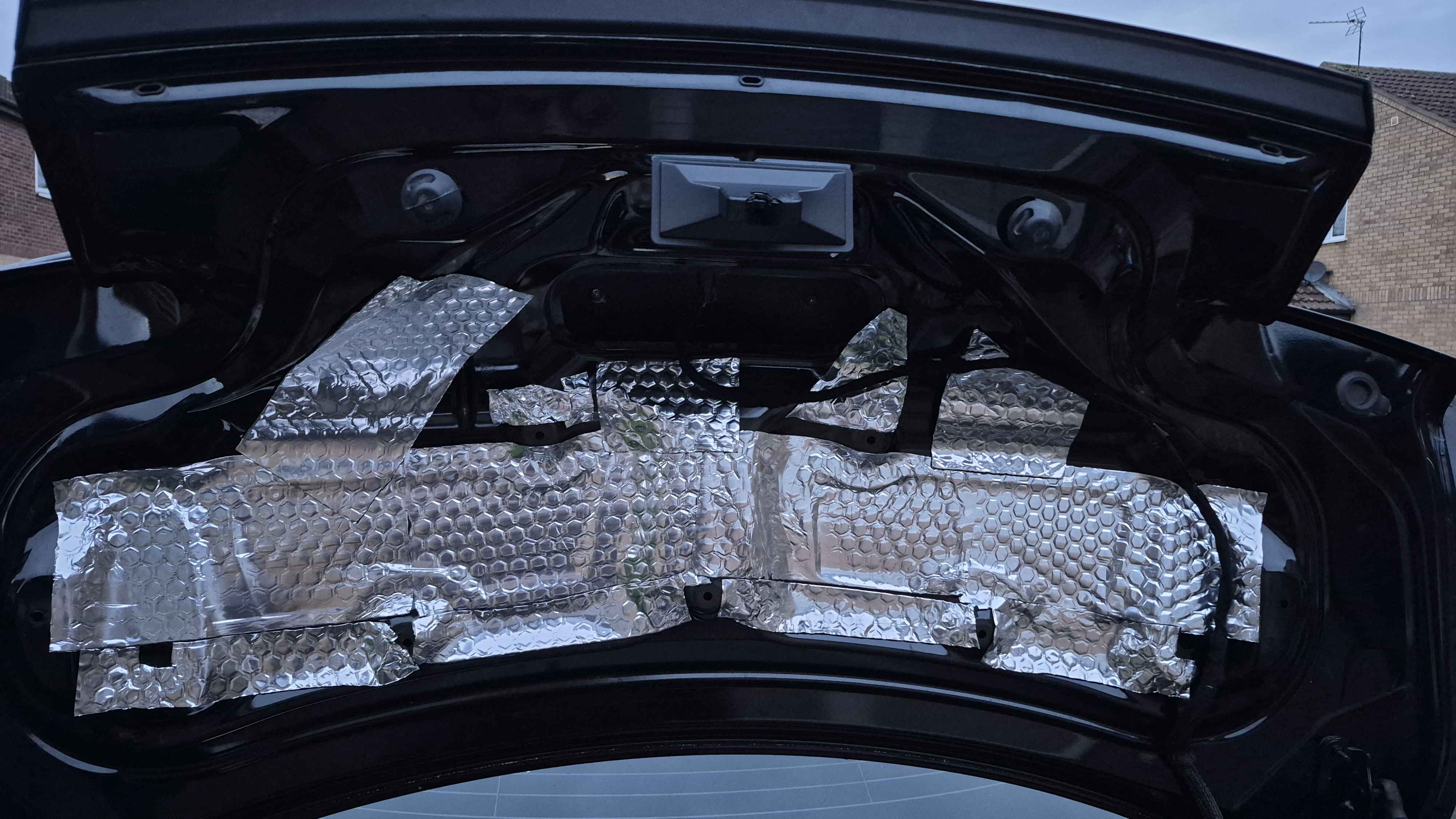

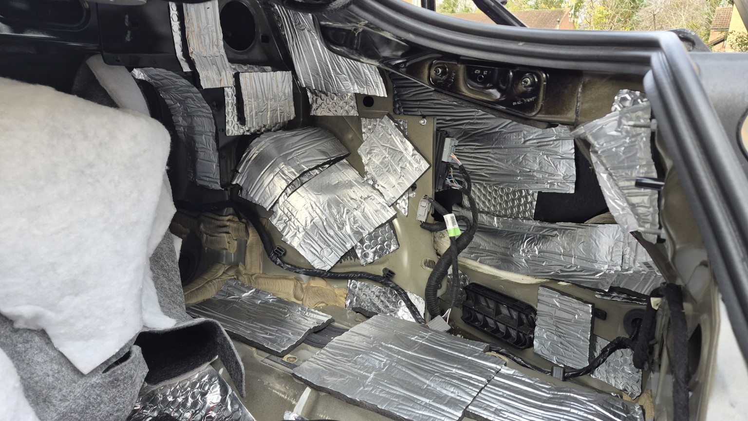

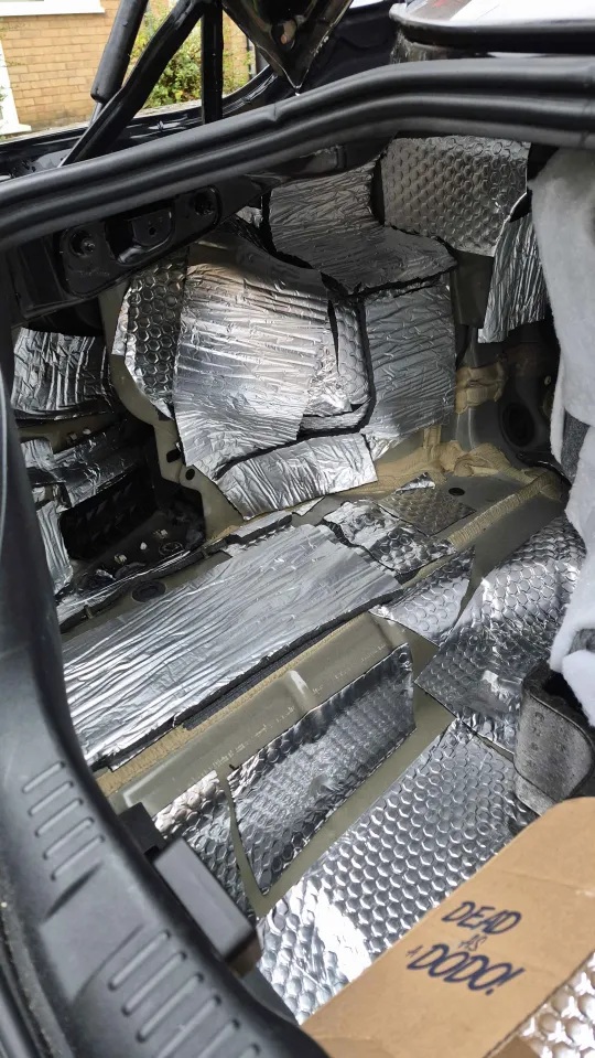

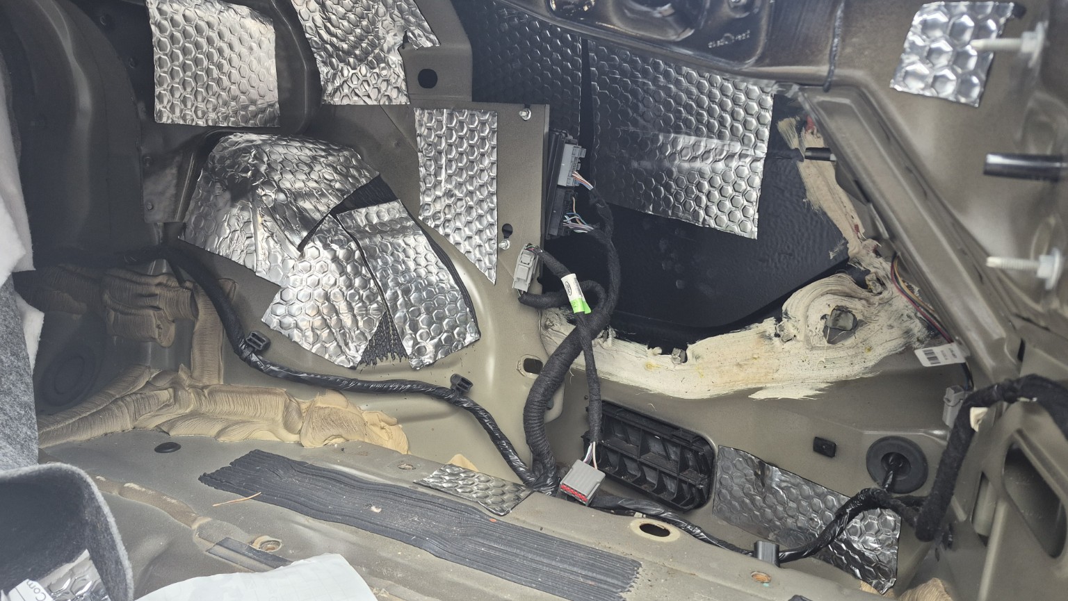

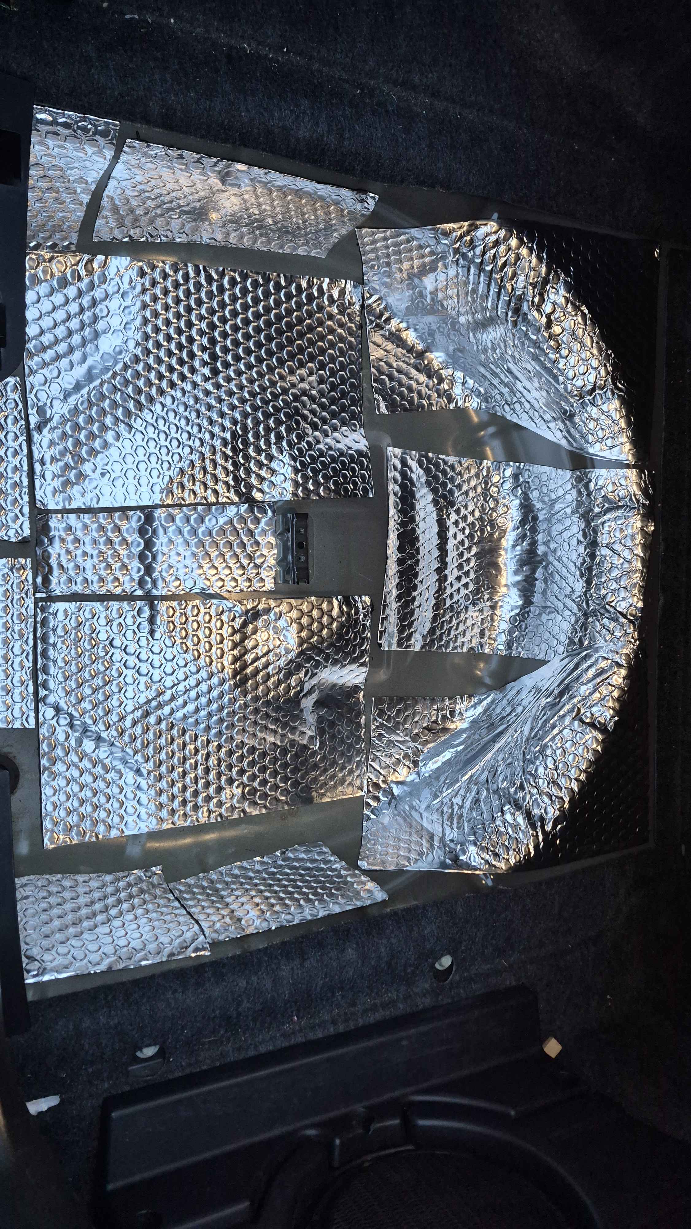

4. Use the extra deadening material in high value areas: Spare wheel well, Boot lid, Rear quarter panels (wheel arches especially)

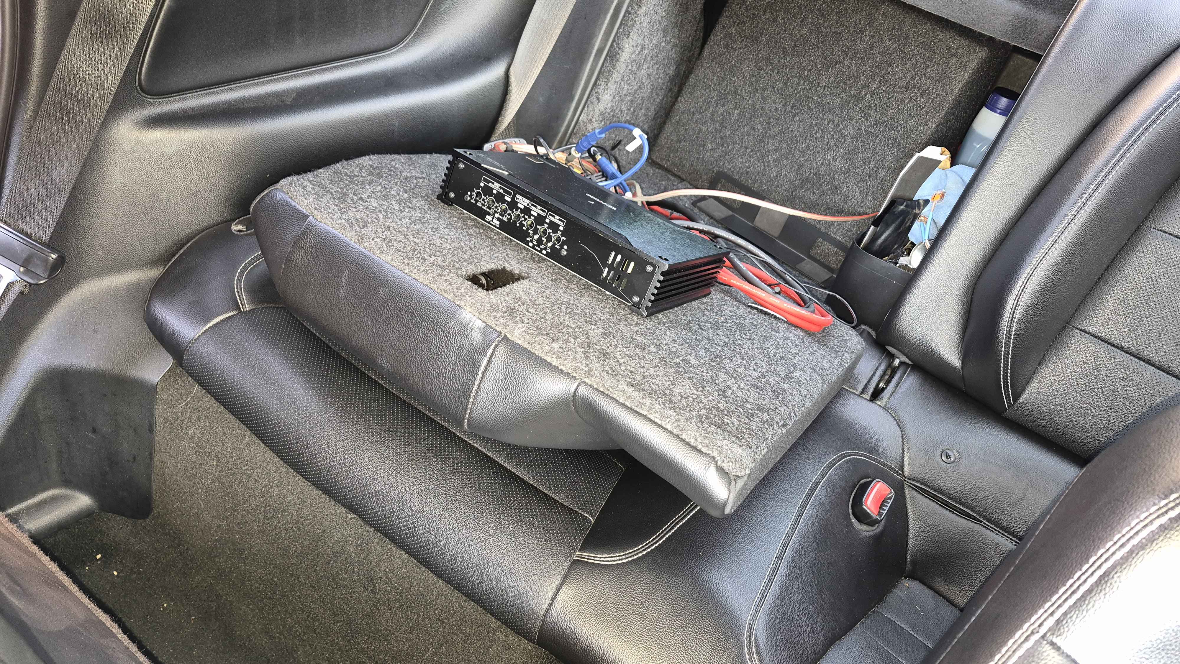

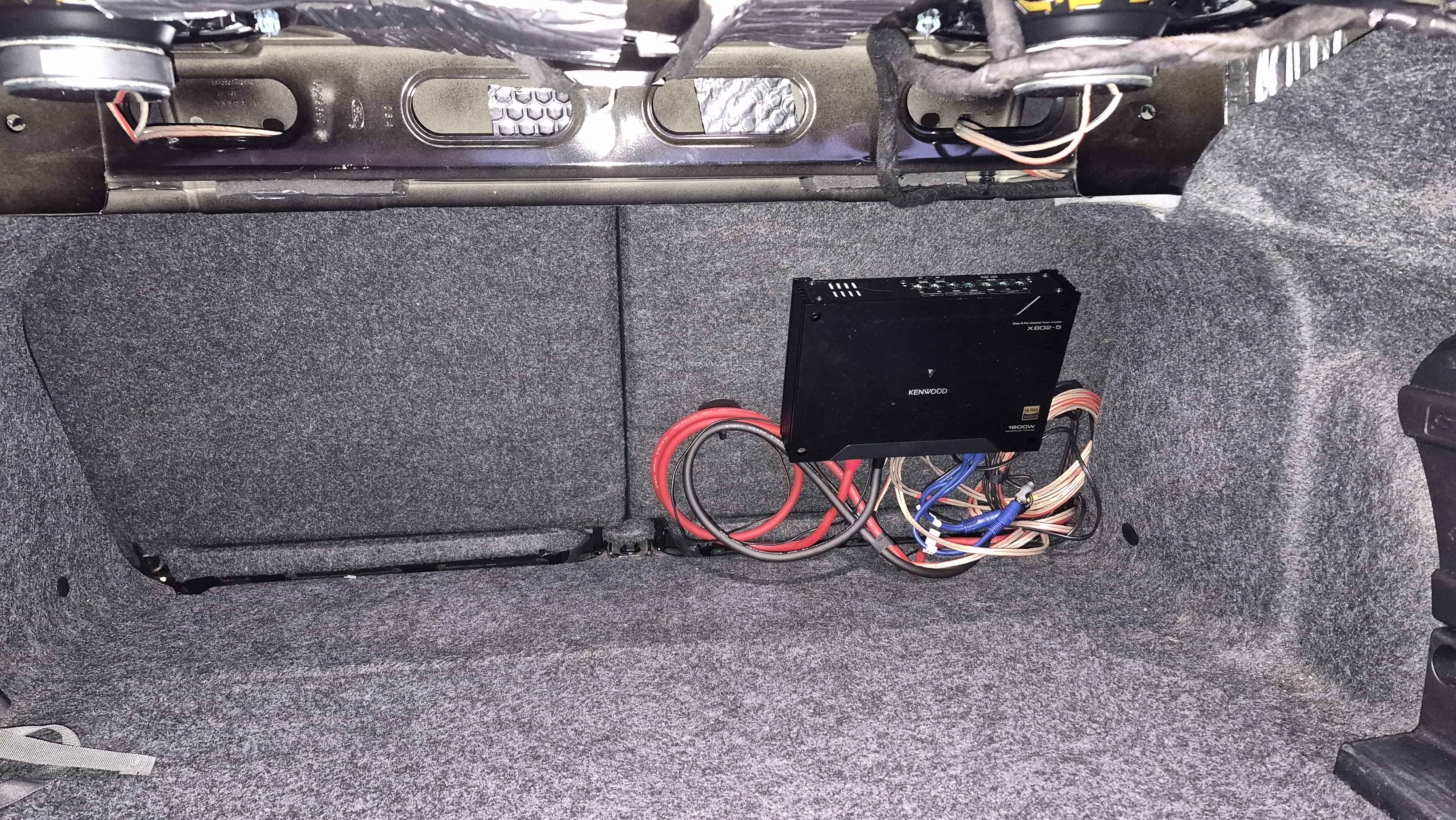

6. Amp in, mounted on the rear seat so it's easy to work on (you'll see)

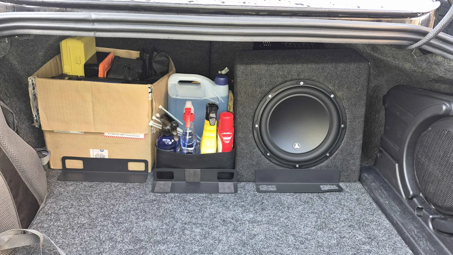

7. Subwoofer in and my tools and **** neatly stored (I don't have a garage)

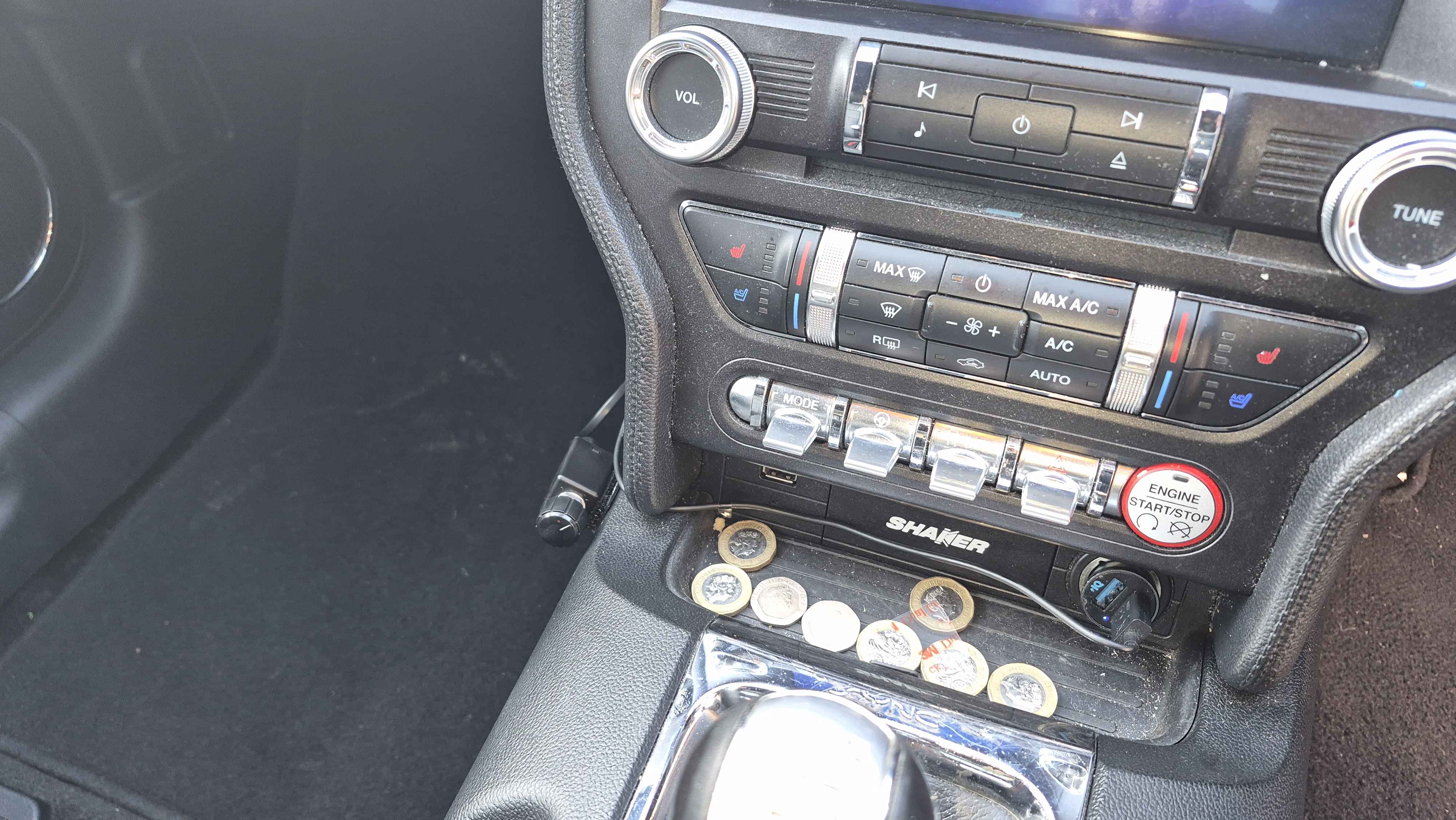

8. Bonus Subwoofer Volume knob installed

I'd definitely recommend damping the doors - it made a reasonably noticeable difference and in all honesty it didn't take all that long to do. I think door 2 took 1hr and that includes changing the speaker out. Door 1 took quite a bit longer but that was me figuring out how it all came apart and how to get the matting on -- and while you're at it you may as well change the front speakers out for a half decent set, you're looking under £150 really, and it'll make a huge difference. The rears are just "ambient" sound, the fronts are what really drive your set up and while the OEM amp will underfeed them you'll still see a huge benefit, but I guess that's only if your current setup is bothering you or you have a spare £200 to throw at speakers and damping.

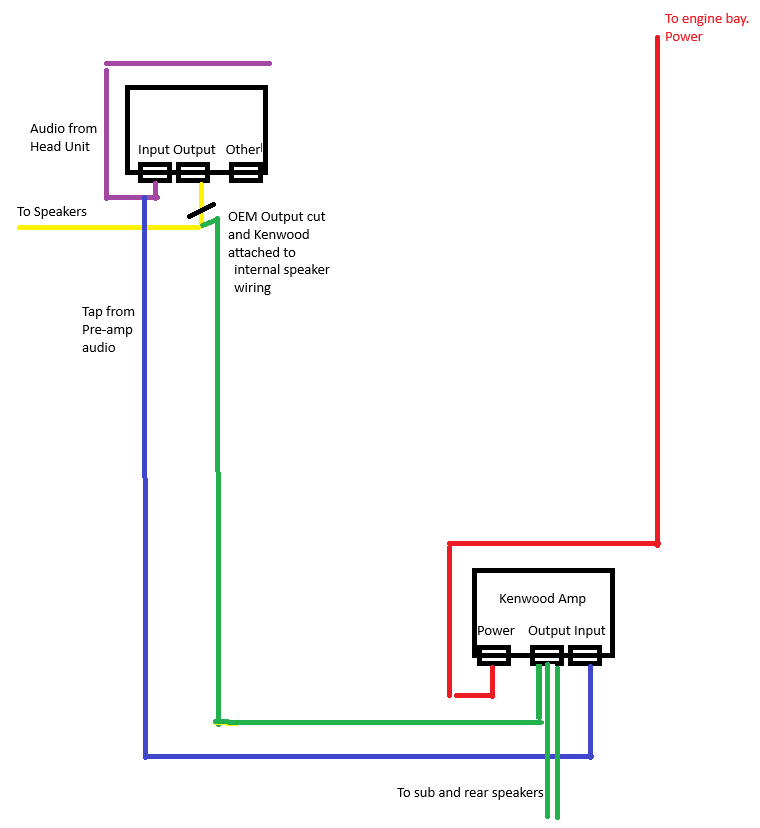

Did you have to run many new speaker cables back to front needing to lift carpet/remove-seats, or could you utilise existing ducts.
any particular set of trim tools you recommend ? (I've used wooden kitchen spatulas a couple of times for smaller jobs door locks/wind mechanism - but need to get something stronger)
Not too many. I tapped the audio from the connector going into the amp - used an RCA cable and snipped one end off for that. Then there's a speaker cable running from the boot back towards the amp and that pumps into both (I've split it) the front door 6.5s and then a run .... Infact it's easier if I just doodle a sketch in paint xD
Bit basic but that's essentially all the cable runs. I've used an RCA (blue) and then 2 speaker cables (green) to the front that go to the front 6.5" woofers. There's also another splice on the end of the green that goes to the tweeters (again, fresh speaker wire but only run from the footwell into each A-pillar).
I guess you researched sound deadening strategy and there is no easy way to create a template/pattern for whole door with a big dodo sheet, cutting slots.
Depends on the materials you use. I used about the thickest foam you can get away with behind the door panels and it's horrible to do those slots - some of the thinner deadening material you could definitely do it though (and audio shops tend to do it that way, looks a lot nicer but functionally it's not really any better). You can't use a big sheet on the outer-skin though as you only have those small cutouts to get pieces through.
ok so amp had better quality rca output directly from HU, versus taking speaker outputs, and EQ&volume is in the head unit;
could also splice an external dac running on a phone into RCA inputs. (on previous car had put an inline 3.5mm plug/socket on rca's to be able to plug in phone)

What are those black brackets holding things back? How do they work (Velcro?) and are they any good?
Boot anchor things: https://www.amazon.co.uk/dp/B0FL2C79R6
And yeah, they're just velcro. They work surprisingly well tbh. I've got velcro on the bottom of the sub too which keeps it in place, I've got anchors infront and behind it just as an extra measure 'just in case'. I've never had anything slide around or move them so far - well worth the money imho. You can get more expensive ones that are bigger/more secure or whatever, but I've not needed more than this.
