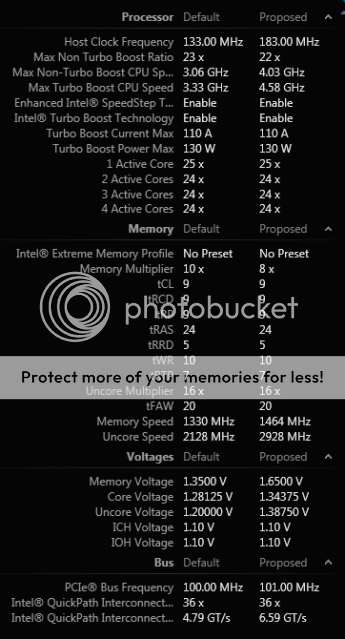

heres some of the settings not sure if what you needs lists on there
The proposed bits are what its at now, been running at those for months.
If not i'll have to go digging into the bios
looks fine to me,uncore voltage 1.38750v looks right for that overclock,i could understand cold boot errors/loops ect but not once warm
could try one/two clicks more uncore voltage see if that helps
cheers, might give that a try.
That screen shot is from the 'Intel Extreem Tuning Utility' that came with the motherboard. Its got an Autotune option which looks like it'll try different overclocks till it reaches one it likes.
Anyone have any experience with this? or is is best to avoid letting this do its thing?
you can clock it yourself but looking at those settings/voltages it looks ok,cpu voltage and qpi/vtt look fine,might need to tweak uncore vtt a little idk
you can use upto 1.45+ for uncore vtt but you shouldnt need that much imo
