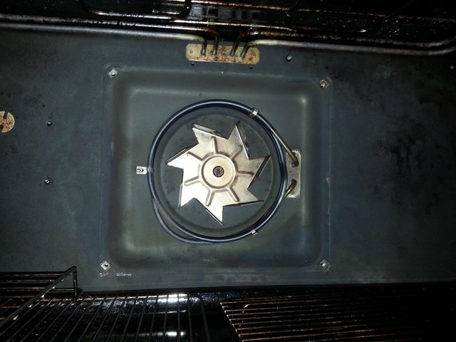

1. My fan oven has stopped heating up. It's definitely the element as I've taken the cover plate off in the oven and there's a big bulge in one part of it. However the wonderful Electrolux has seen fit to make one of the three screws accessible from inside the oven, and two of them accessible only from the rear:
Rage etc.
Therefore I need to safely remove the oven from the wall. I've isolated the mains, but how do I safely deal with the gas pipe?

Anyway thanks for the replies. Here's a photo of the broken element for what it's worth:
Why oh why couldn't they have made the screws accessible from the front.
Is it going to be hard to access from the back do you reckon? I just had a go at pulling it out from the wall and failed miserably. There's just nowhere to grasp that won't break something, and it's rather heavy :(.
There will be a panel on the back, you will just unscrew it. There will be two 7mm nuts holding the element in.
