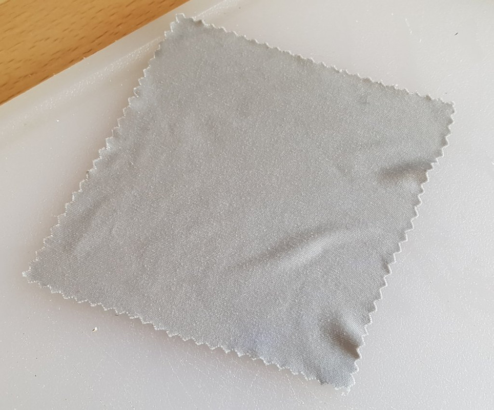

As it happens though, the problem was a small microfibre cloth stuck in the pump! So I guess

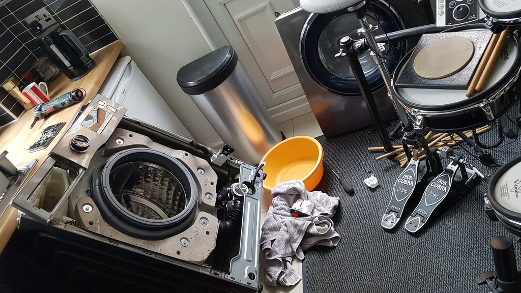

My engineer just came around. Not particularly friendly or helpful, no smile, came in like he was doing me a massive favour. Hate people like that.As it happens though, the problem was a small microfibre cloth stuck in the pump! So I guess
technically not a warranty issue. Nevertheless he said it's the most common callout thing.

I think the lesson is, don't put any items in the machine that are too small.

hope he is supporting that 70kg? stably, and not propped against work surface.
How did the first piece of cloth get into the pump ? between the drum&door - can't see one of those (sorry gimmicky) trap doors,
presumably it didn't interfere with other pump he is now investigating -
two pumps though ? I thought there was usually some kind of bellows to re-circulate water into drum top.
Yeah that's a good point you make about how the cloth had gotten into the pump. I mentioned to the engineer that just once a few weeks ago I had a pool of water around the washing machine. It's not happened since fortunately. He said that can happen if the door isn't completely sealed when closed. Which based on what you said makes me wonder if it had got trapped between the door and drum but I don't know if that's when I had the leak.
