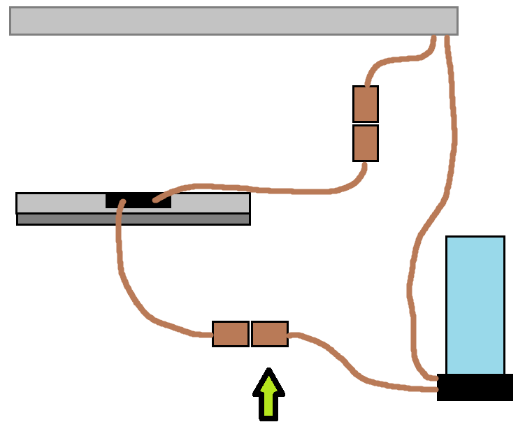

As I'm using some quick release connectors for the GPU I should be able to just utilise those right? I'll just need a spare quick release male or female connector to release?

Horrible illustration:
You could do, there's nothing wrong with doing it that way but it means you'll have to take the QD off to drain it. You can't just pull back on the Quick release to drain, you'll have to unscrew the fitting altogether to drain it.
I still think a drain valve on your res/pump at the bottom would be the best option, it will allow you to attach a G1/4 barb and attach tubing to it so you can direct the coolant to a bucket to drain.
For drain, a Y fitting or a 3-way splitter plus a ball valve at the inlet of the reservoir should be good to go.
Quick disconnect are great, but for a single component, not really necessary.

Yeah can use quick disconnect
Very useful to save draining everything
As jay85 said you still need to get the coolant out though
Once you disconnected the GPU
I just push in the centre of the quick disconnect
With a screwdriver etc
And let it run into a jug
Though I also have a drain valve too
The quick disconnects just let me remove individual components
Should the need arise
