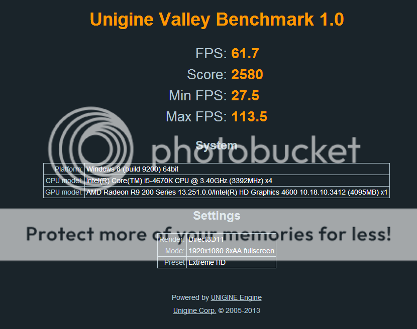

Next I ran Valley again and got the following:
Now this ran smoothly apart from 2 scenes were I seen some VERY SLIGHT artifacts (blue squares). Finished the benchmark though and again, some slight improvements which is great.
