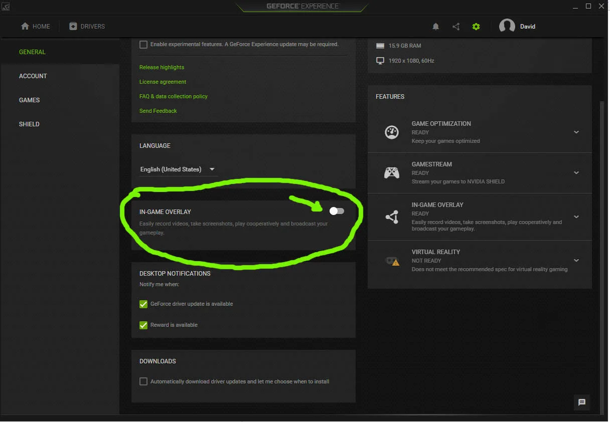

Interesting. If I run "Idle Clock" from maxoutput.com, on both my PCs...
On one it immediately counts up and resets with any mouse movement etc.
But on the other PC which is NOT showing the screenserver, the idle clock refuses to even go up at all! It just stays at 0!
It's a bug with the NVidia Drivers or something like that.
Turn off the IN-GAME OVERLAY and all's OK. Turn it back on, and the Idle Timer fails to go up, and so no screen saver etc...
