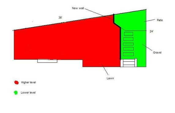

At present, our neighbour who doesn't join us has her garden at the 'narrow' end and it at the higher level. The neighbours who join us at the longer side, they are at the 'lower' level and finally at the real, they are also at the lower level. There is, however, a retaining wall at the bottom of the garden. As you can see from my masterful MS Paint renderings, there are some delightful flowerbeds built up along parts of the garden and those eat up quite a bit of room in what isn't the biggest garden to start. Add to that we are both in full-time employment and it's too much hassle to deal with to be honest.
My plan, and a cunning one at that, is to 'fill', the majority of the garden , ripping out the flower beds, and levelling up to the same level as our back door. Then, about 75-80% along, building a retaining wall and having a sunken patio/gravel area, few pots and such-like. Easy maintenance, with a nice turf lawn. THe depth of the area to fill is between 2ft and 3ft. It should look someting like this amazing piece of artwork that would shame Monet and Van Gough

Going to be 3' from the top level to the bottom, planned that the 'wall' wouldbe usefull sitting area also. I had wondered about steps at the bottom (the steps at the top would remain as they lead out from our french windows) but I am worried about not having enough lawn.

Doesn't resolve my issue of wanting a lawn all on one level and also hee need to have a two-level garden. I'll try and sort some pics tomorrow after work, bit dark now:)
