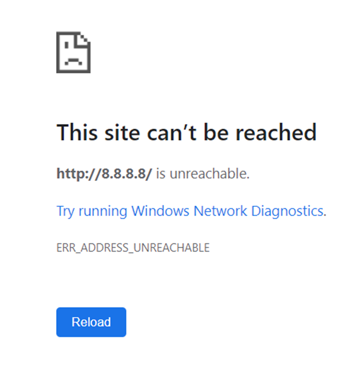

When it's all gone belly up, can you ping the Pi-Hole instance? Can you ping something on the internet by IP address? Try to ping 8.8.8.8.
I'm expecting it to go **** up tomorrow morning, but I'll try the 8.8.8.8. I was definitely unable to access the BT hub settings page 192.168.1.249 or my servers IP address. I had to reset the BT Smart Hub to factory settings to turn DHCP back on
What's the IP address of your Pi-Hole?
Just got home from work and as expected the 24 thing happened again.When it's all gone belly up, can you ping the Pi-Hole instance? Can you ping something on the internet by IP address? Try to ping 8.8.8.8.
When DHCP renews and it's all gone to pot, do an 'ipconfig /all' from a command prompt and post that too.
