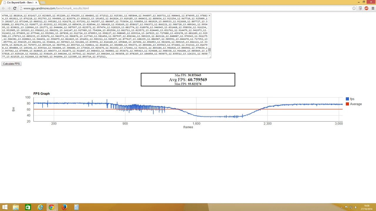

my translated data from earlier
1920x1200 (not 1080p but chuck it in there anyhow)
DX11
GTX980 1503/2013
4930k @4.5
344.48 driver
** Any image wider than 1280 pixels should be linked or placed in spoiler tags **
http://i.imgur.com/XTTVqjD.jpg

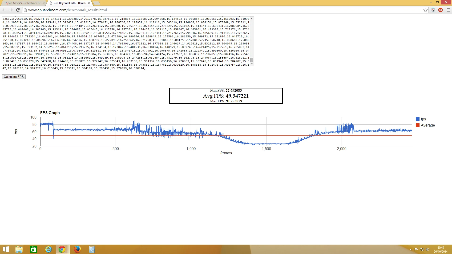

Another for the scoreboard
1080p
DX11
7950 @1250/1600
2700k @4.2
14.9 Driver
Noticed only around 75-80% gpu usage, and cpu only around 50%.
May try again later at 4.5 with HT disabled and see what happens.
edit: bigger image
1080p
DX11
7950 @1250/1600
2700k @4.2
14.9 Driver

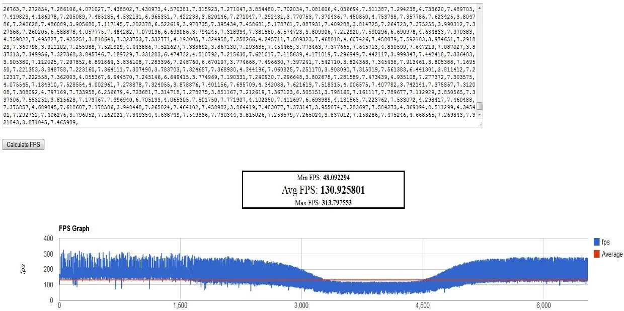

New 1080p run, curiosity between the two got the better of me
1920x1080
DX11
GTX980 1503/2013
4930k @4.5
344.48 driver
