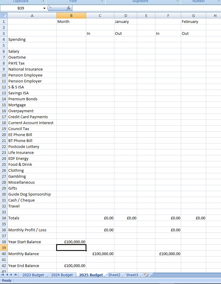

Hi All,
I've put together a simple budget spreadsheet for my monthly income and outgoings / spending habits to see where my day to day spending goes. Usual stuff on there, salary, tax, bills, food, credit card etc and at the end of the month I've got a 'Profit / Loss' depending on how much i stick to saving / splurging!
I'm also wanting to see where my annual spending goes on each of my individual groups. By and large there's no issue of doing the calculation of =sum(A1:A10) and the total will appear, the difficulty lies is that this just does a complete total of all the figures but as my colulms have an 'In' and 'Out' heading i want the money going in to be separate from the money going out so that when they're totalled it gives the correct total e.g (A1 + A3 + A5 + A7 + A9)-(A2 + A4 + + A6 + A8 + A10) = Total.
My first thought is that off to the side of the spreadsheet I can do separate totals then take one from the other but I was wondering if there was one formula to do both?
Afraid i'm fairly basic with Excel, but in this case I would be putting my income in 1 column and outgoings in the immediate next. Then total both columns separately and then show the difference.
I don't think i was overly clear. I have monthly columns with income and outgoings that deals with my general expenditure so i have monthly totals of my various expenditures over the course of the month for each month. Horizontally I want to see what the total spends are for each of my headings so my total salary will line up over the course of the 12 months, my total bills, my total food outlay. It only really gets a bit tricky if I'm transferring cash from one account e.g Premium bonds or if i 'bank' any winnings from gambling. So for example if i spend 500quid on gambling but I win 200 quid if i total up the horizontal line with all my gambling it'll say I've spent 700quid rather than a 300 quid loss so thats why I'm looking at a calculation which can total up alternative columns to give me the correct total.

You say "my columns have in and out headings". So is it two different columns? Or have you got the values in one column and whether it's an in or out in the other?
I should have put this in the first post!
So I've got my running totals over each month at the bottom so i can see what I'm doing there. As above each month has an income and outgoings column. What I'm trying to get is the totals for the 12 months in each of the horizontal headings so that i can have a further breakdown of where I'm spending my cash.
OK you could create another column between A and B as "Yearly" or something. Then use SUM for the horizontal like =SUM(C6:XFD6) for row 6 ?

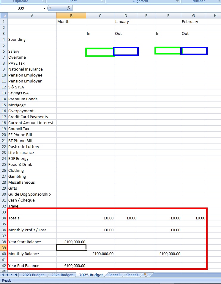

Ok I'll try again here.
The boxes marked in red I've already got my sums sorted out for the running totals per month. I want to add the figures highlighted in Green added each month and in the same 'total' I want the figures highlighted in blue subtracted away. So if the Gambling heading has January £50 out, February £25 out but I win £125 I would put the £125 into the In column where as the rest is in the outgoings column. If i did a simple =sum(C:27:G27) formula I'd get a total of £200 instead of £50. I would be putting these totals after the December columns at the end of the spreadsheet.

I'm just watching a tutorial on that type of thing. I've done a quick fix with what i suggested in an earlier post and divided each heading into money in and money out and then subtracted one from the other to get additional totals for each item listed.
Used your gambling example because you gave actual numbers - not because I endorse it :D;)
Using SUMIF we're saying only SUM if you match the criteria, in this case, the column header is "in" (or "out"). You don't have to create separate in/out sums, could roll into a single total by having SUMIF(the in columns) - SUMIF(the out columns).
