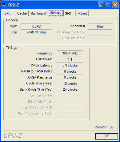

16 mefinks :D Thats a guess though. You might be better off knowing 100% before you set it at 16. If you know the default SPD table on your ram type to be at an optimum setting other than a 'failsafe default' then set it to auto and check in CPU-Z 'Memory' tab and all will be revealed for you to set all in the bios manually
Thanks for the reply. CPU-Z shows the following.
Is "Bank Cycle Time (Trc)" the same as "DRAM Write Recovery Time" or is that just coincidence?
(it's at 390Mhz as the motherboard doesn't seem to like 400Mhz anymore :()
No, DRAM Write Recovery is tWR and it should be similar to the CAS latency figure eg. 4 or 5.
