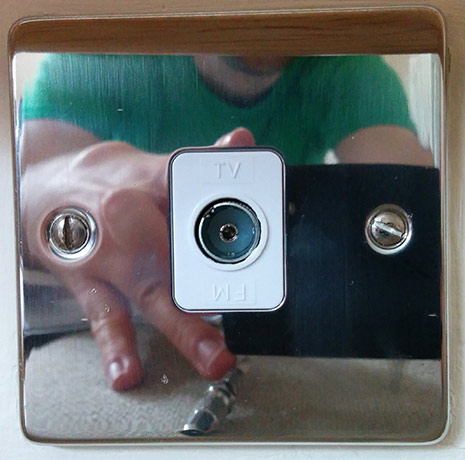

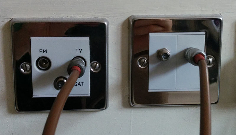

Hey, one last double check seeing as we'll be getting a new TV soon and deciding when we should start getting out of the Sky contract...
The source aerial face plates (non-TV room) are in the top image showing the connection required to make the coaxial faceplate in the TV room work - the bottom image. The signal also works if the two plugs on the right face plates are connected to each other.
No other combination transmits a signal that the Freebox registers. I've just been seeing if the Sky box gets anything with any combination when plugged into the normal coaxial in the TV room (bottom image)
When the Sky HD box was installed the two f-connectors fed directly into the Sky box (when in the same room) and that worked.
So, is lucid's word final and that as we have a signal distribution box under the stairs no satellite signal will work out of the coaxial face plate? (bottom image) Happy to ditch Sky HD and use Freeview HD if that only needs one coaxial lead.
The way that the triple socket (FM/TV/Sat) works is that it is band frequency filtered. What that means is that although the FM, TV and Sat signals all occupy different frequency ranges, the distribution amp combines them and outputs all of them together down a single coax to each wall plate.
They remain distinct because they operate at different frequencies. The wall plate then has filters which pass or block certain frequencies. So the TV socket only passes signals in the 470-790MHz range.
FM............ 88-108MHz
DAB......... 217-230MHz (FM and DAB are usually combined as 88-230MHz)
Digital TV... 470-790MHz
SAT......... 950-2300MHz
This means that if you're trying to get a TV signal out of any socket other than "TV" then you're wasting your time. Ditto for FM/DAB and for Satellite if they are present at the amp end.
If you want a satellite signal from the LNB cable transporting from one room to another then you need either to send the signal in to the amp first (in your case, under the stairs), or you need a direct physical connection from one room to the other i.e. a bit of wire that does not go via the aerial amplifier/splitter. Both of these solutions require dedicated cabling. There's no getting away from this.
If you want to move the Sky box (or any Satellite receiver) to room 2, then really the best solution is just to get two new LNB feed cables off the dish direct to room 2. Simple. Job done.
