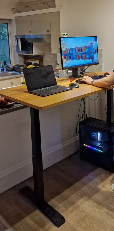

I just got my first one the other day, loving it so far. Managed to find a basically new FlexiSpot E7 and 160x80 worktop with the Ergo chair for £140 off facebook marketplace. I was just using some silly kitchen table before. This is so much nicer to work at! Still have to do some cable management but I love it.
