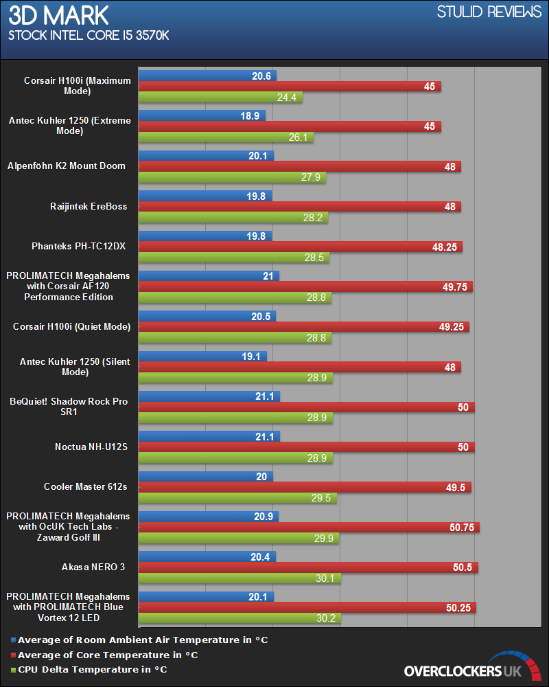

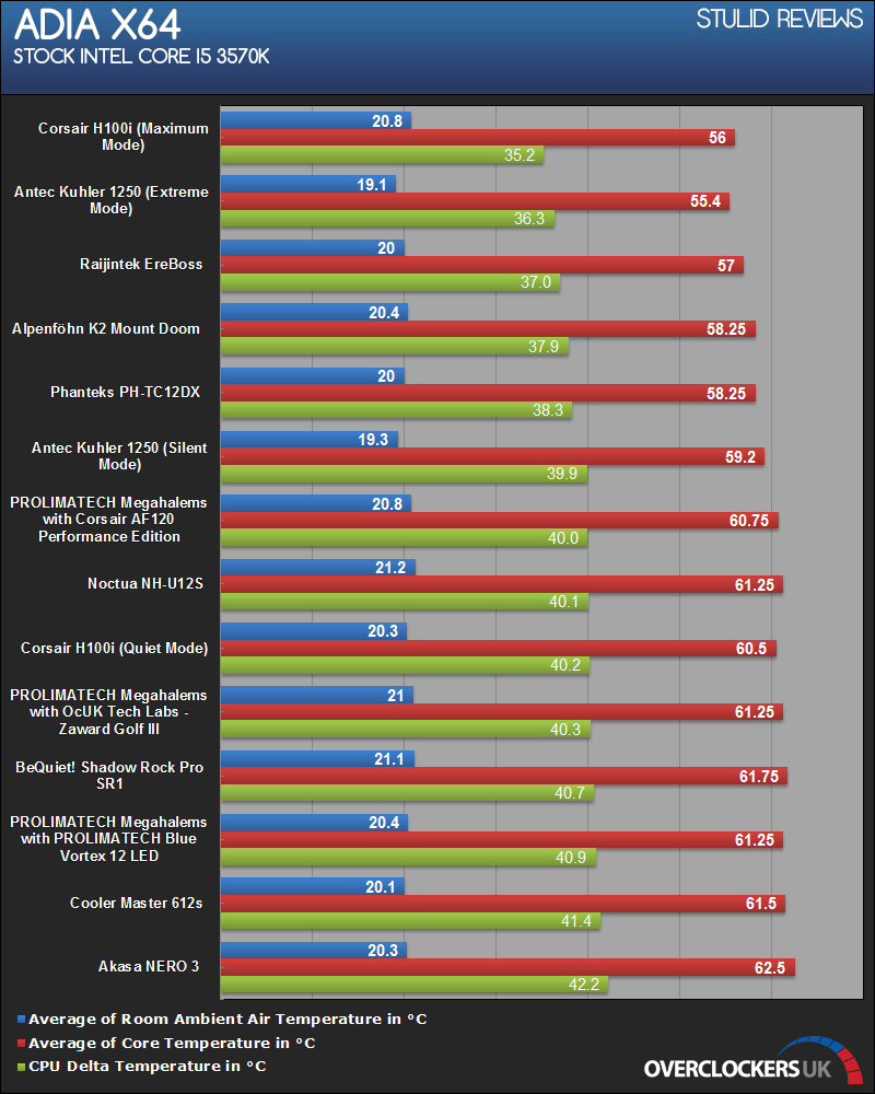

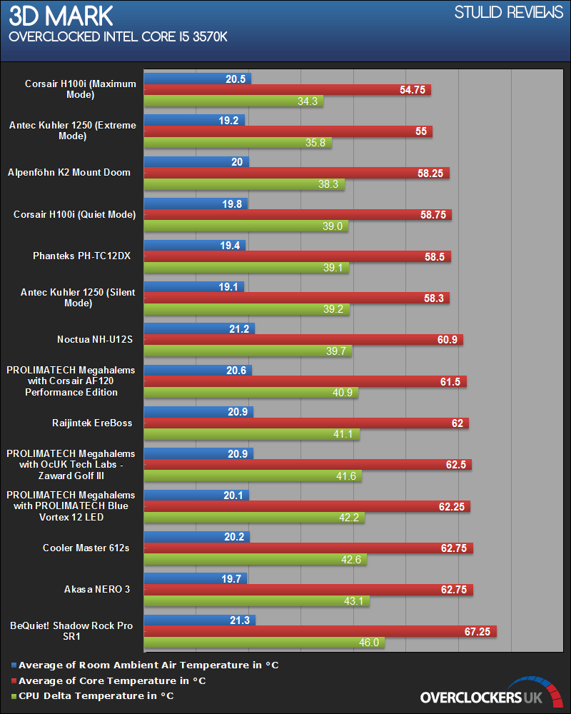

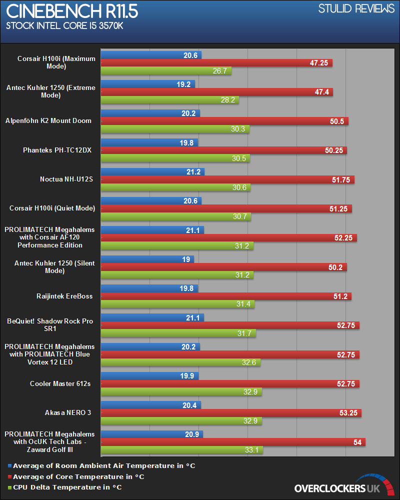

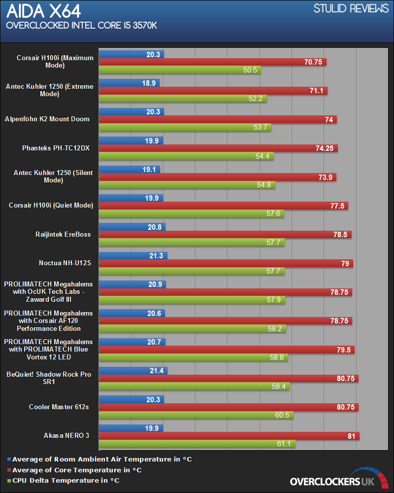

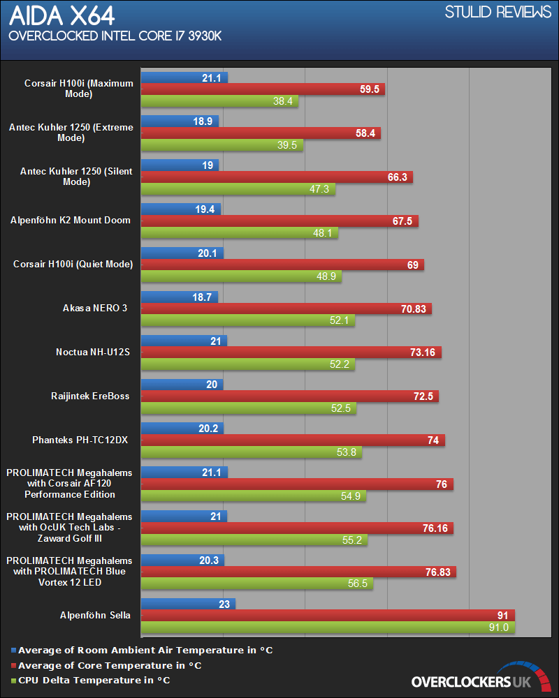

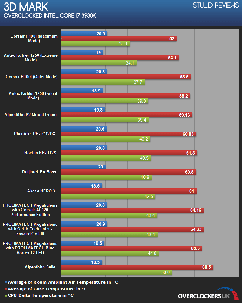

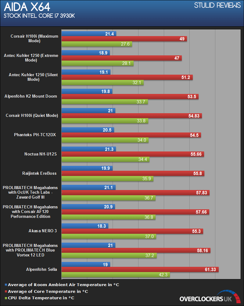

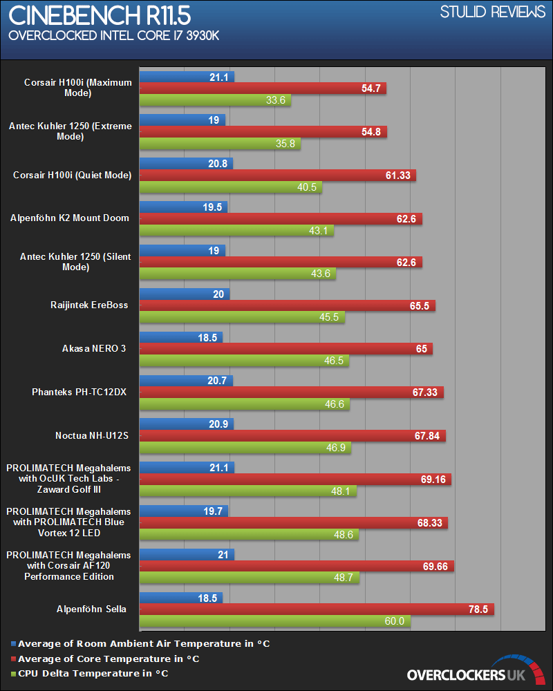

I recorded the maximum CPU core temperatures with Coretemp after running AIDA64 stability test for 20 minutes and divided the total by the number of cores.
The latest 3dmark release was left to do a full run of all tests. Cinebench 11.5 64bit CPU bench was also used.
I have a Hilka Thermometer & Hygrometer to measure the ambient air temperature.
All the coolers speeds were left to be automatically controlled by the motherboards used which I feel is more common with people who will just "fit and forget" and not set any maximum fan speed etc.
I used the same Gelid GC Extreme thermal paste in all the tests and this does not require any curing time.
Temperature results.
It is the green bar that shows the delta temperatures.
Z77 Stock.
Z77 Overclocked.
X79 Stock.
X79 Overclocked.

Conclusion.
I may have included a number of different tests but ultimately it is the overclocked X79 AIDA64 result that shows the differences between these heatsinks with the H100i leading the pack but only when it is set to its absolute maximum fan speed, the Alpenföhn K2 Mount Doom on the other hand is able to compete with the H100i while remaining quiet.
The Akasa Nero 3 shows mixed results and this is due to the way my version mounts to socket 1155 using push-pins, yet for X79 it uses four spring loaded screws with importantly no safety stop to stop you from over-tightening the cooler, yet good clamping force can make a huge difference to the performance of a heatsink and it is this that I think helps it perform excellently on the X79 setup.
* Please not that the Akasa Nero 3 on sale now has done away with push-pins.
The Phanteks PH-TC12DX puts in a good showing with its push/pull fans but is louder than the rest it is also a pleasure to fit with a good mounting system and the wire clips don't fall out of the fan as you try and fit them to it's body.
Prolimatech Blue Megahalems is one of the most stunning heatsinks I have seen, it has a beautiful finish to it and if you select the right fan is cool and quiet it is also a easy heatsink to fit..
The Coolermaster 612S looks like good value for money and is a quiet heatsink even at full 12V, the only downside is it's really annoying to fit.
I never really expected the Alpenföhn Sella to cope with the X79 setup when overclocked and when running the AIDA64 CPU stability test the CPU started to throttle as the core temperatures reached the 91C TJ max. But if you want to use a X79 at stock speeds in a small sized system or just need a cheap heatsink to get you up and running until you decide on what performance heatsink to go for or want a back up of you are water cooling then its a great option.
Bottom line.
It is the Alpenföhn K2 Mount Doom that is ultimately the winner here but it's huge size may be an problem for some people with smaller cases. The louder Phanteks comes in second place and having a choice of colours is nice, the Prolimatech also does well and offers buyers a choice of colours and fan options.
