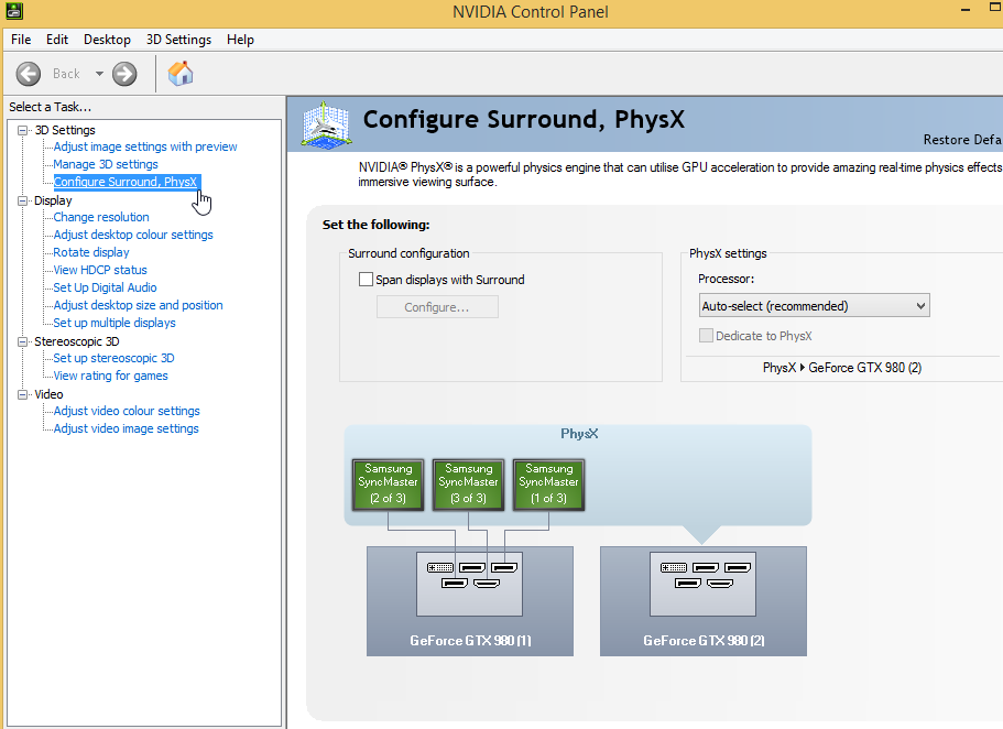

But the one place I think I'm meant to see the option to enable SLI, I don't...
I uninstalled via programs and features all the drivers before re-installing them again. Any other tricks I can try? Do I need to change a setting in my BIOS? Do I need to make sure the SLI bridge is on the correct way? Literally nothing is too simple for me to check as like I say, I've not done this before.

This is going to sound really daft, but...
On the last picture look where your mouse pointer is
Click on manage 3d settings
Click on "maximise 3d perforance"
Looks like your looking on wrong screen. Apologies if you have already done this

Aye, sorry, obviously you guys are so amazing at replying and I obviously can't see what's going on while I was looking at BIOS settings etc.
But yeah, came to the same conclusion as Nelly from the manual but then figured it might be worth a try in the different slots.
