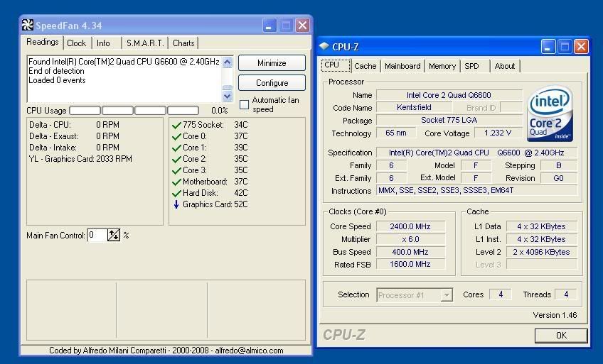

with a good after market cooler you can run overclocked fanless *goes to turn his fans off and show some prime load*
Ok Idle @ 2.4 (Speedstep) - No Fans Left it for a couple of mins

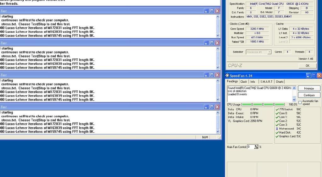

And Load @ 3.2 - Not for to long granted but I doubt that your trying to run a folding rig 24/7 if your under-volting and clocking..
And I realise its not totaly fanless with the aftermarket graphics cooler fan going but then I can't be arsed to take the case apart and put it on a 3pin connector on the board that allows speedfan to control it :p
