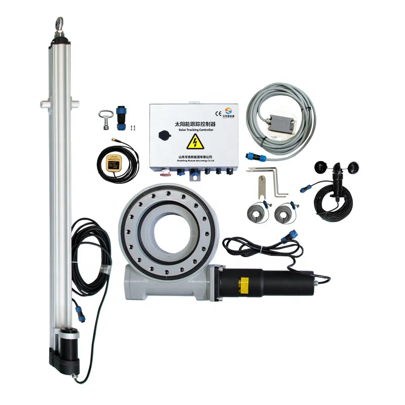

I think the ideal would be having the whole PV array on a rotating platform that tracked the sun. Something like that must exist.
Do you mean in a portrait / landscape configuration....or literally at 90 degrees to the horizon?
They do for ground installs, although individually is all I have seen
Just a simple motorised column in effect. Not sure if they track via actual sun or via data based positioning. Later I assume.
I would assume they generate something like 125% of a south based array.
