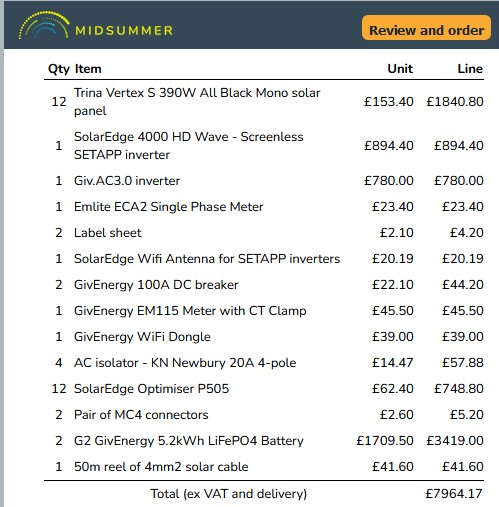

Interesting, just came up with this - bare in mind this is parts only, no installation, also no real idea of what's needed and what's not, or lengths of cables, and there's no fixing frame work included either.
Not sure if the optimisers are required although the roof does get some shading late afternoon, which will be worse in winter months.
This would be in addition to our existing 4kw solar array.
Although this is more palatable
Shouldn't you be using the hybrid inverters if you're intending to charge from both solar and cheap rate? It will add another £300-£400 or so per inverter.
@casper_uk I think it's related to wind loading, but it's certainly not happened on our install, and we've had some very strong winds in the last seven years.since they were installed and they've been fine so far.
@94JDH I'm not entirely sure, I'm still waiting for actual installer's to come back with quotes. The garage roof will suffer shading in the late afternoon, this will be worse in the winter and better in the summer, hence the use of Soleredge and optimisers, the same as our existing house roof install.
The planned array is for a detached double garage, we have an existing array on the house, I thought we'd have to use a separate inverter charger to use the power from both arrays to charge the batteries. Though I suppose we could have one battery in the house, and another in the garage.
