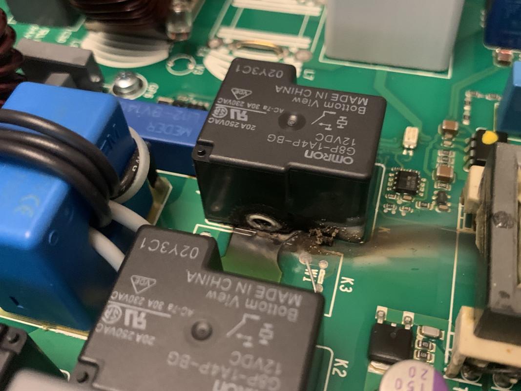

Got home today to find my system is t generating any power. Climbed up into the loft to inevitably find the inverter is showing a fault code.
Decided to take it apart to investigate this known fault specific to the brand of inverter I have and found this.
I know a guy that can hopefully fix this other wise I’ll be shopping for a new inverter.

How old is it?
Looks like a switch that has gone pop ?
Edit, or is that the remains of a capacitor there?
Edit 2, ah its a relay switch. If its the component itself at the top of the image which it appears to be
If that all thats gone should be a simple fix

So under warranty or not?
Assume not by you saying your going to repair. Or is that because of downtime?
fingers crossed it just nuked itself and nothing else got taken out.
No warranty ran out in 2019 I was hoping it was a 10 year warranty but it was only 5.
I could possibly attempt it myself although we use guy at work that repairs all our boards ect, it’ll be a doddle for him.
