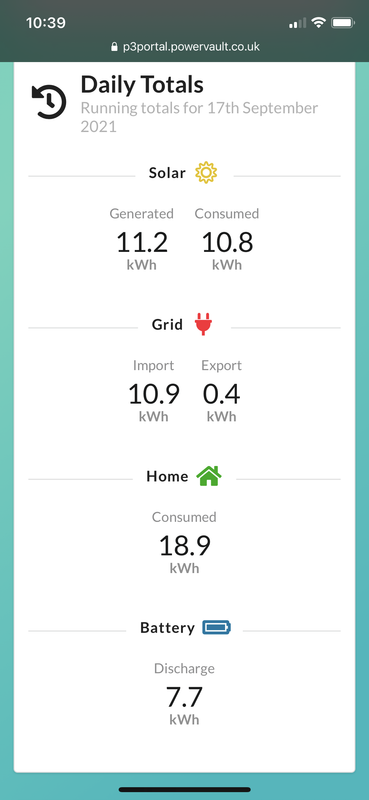

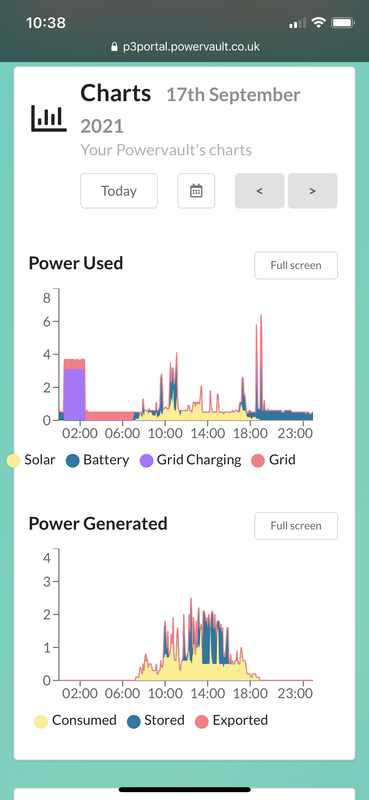

Don’t forget it’s not just about the solar energy you store, you can also use to store cheap off peak electric on a economy 7 tariff for winter months etc.
You really need at least an 8kw battery imo otherwise you’ll still be importing electricity a peak cost.
A couple of screenshots of mine running yesterday.

Just a quick look on my phone and i can't see any pylontech as big as 8.2kwh nor cheap as £2.5k for the equivalent. What have you got and how much was it?
I have the Powervault as per the pics I posted.
