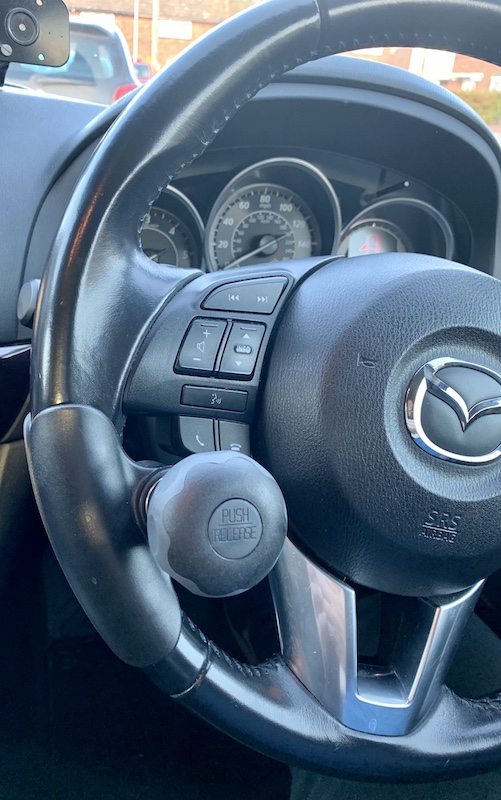

Just over a month ago I broke my right arm badly and have had surgery. I still have very limited movement in my right arm but when I asked the consultant today, he said that providing I'm comfortable, I can drive short distances.
With my right arm sitting in my lap, I'm comfortable. Therefore I need a knob for the steering wheel that I can use with my left arm, just to get me out and about and stop me going stir crazy.
I've searched and there seem to be many different types available.
So, does anyone have a knob mounted to their steering wheel and can recommend one?
Also, where on the wheel should it be mounted? My natural feeling is that it should go sort of bottom left side so my left arm can hold it comfortably at rest and then it be in a convenient place to turn.
I'm expecting ridicule for this but if anyone has any valuable input, then I'm very keen to hear it.
Thank you.

We had to find one for my dad when he had issues with one of his hands.
We wasted money on Amazon/Ebay junk, basically the pitfalls we found
1. The small mounting type (just a basic 2-3cm hoop) will not only be unstable on the wheel, but also will damage it.
2. The knob needs to be as large as possible and preferably have either a nice bearing or high quality bushing, some of them had no bearing/bushing and just showed immediate signs of play/wear.
Just find a local disability shop, they will help!
the type we ended up with looked more like this: https://www.jeffgosling.co.uk/products/steering-aids
That didn't mark the steering wheel,mounted securely and is still going after 2 years!

Just popped into the local one, gave them twenty quid and this happened.
I took a quick drive out yesterday afternoon and my hand sits naturally on the wheel for normal driving, It just dropped to the knob when taking corners or parking when I needed that extra little bit of manoeuvrability.
I didn’t even need to think about it, it just happened.
