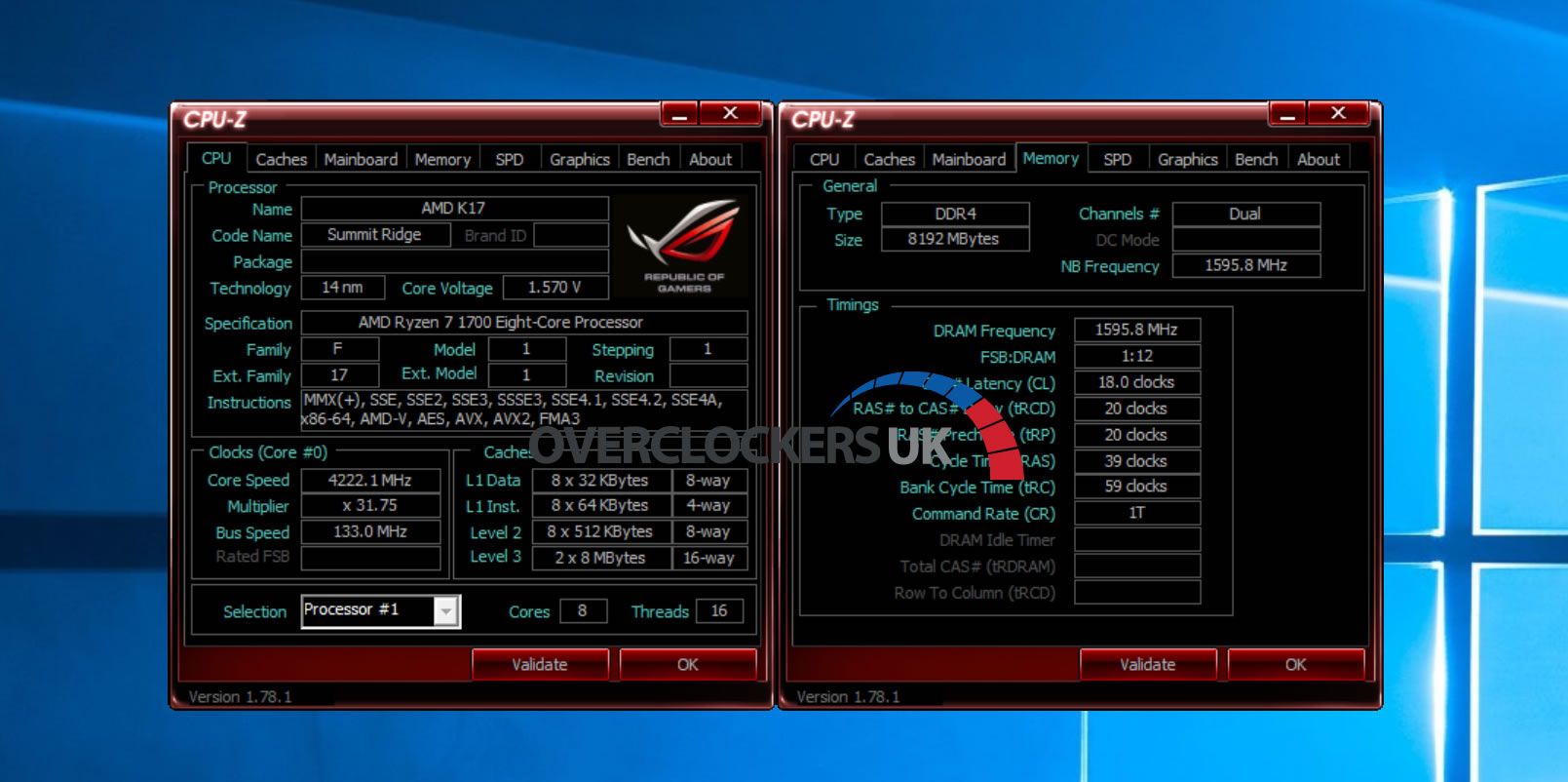

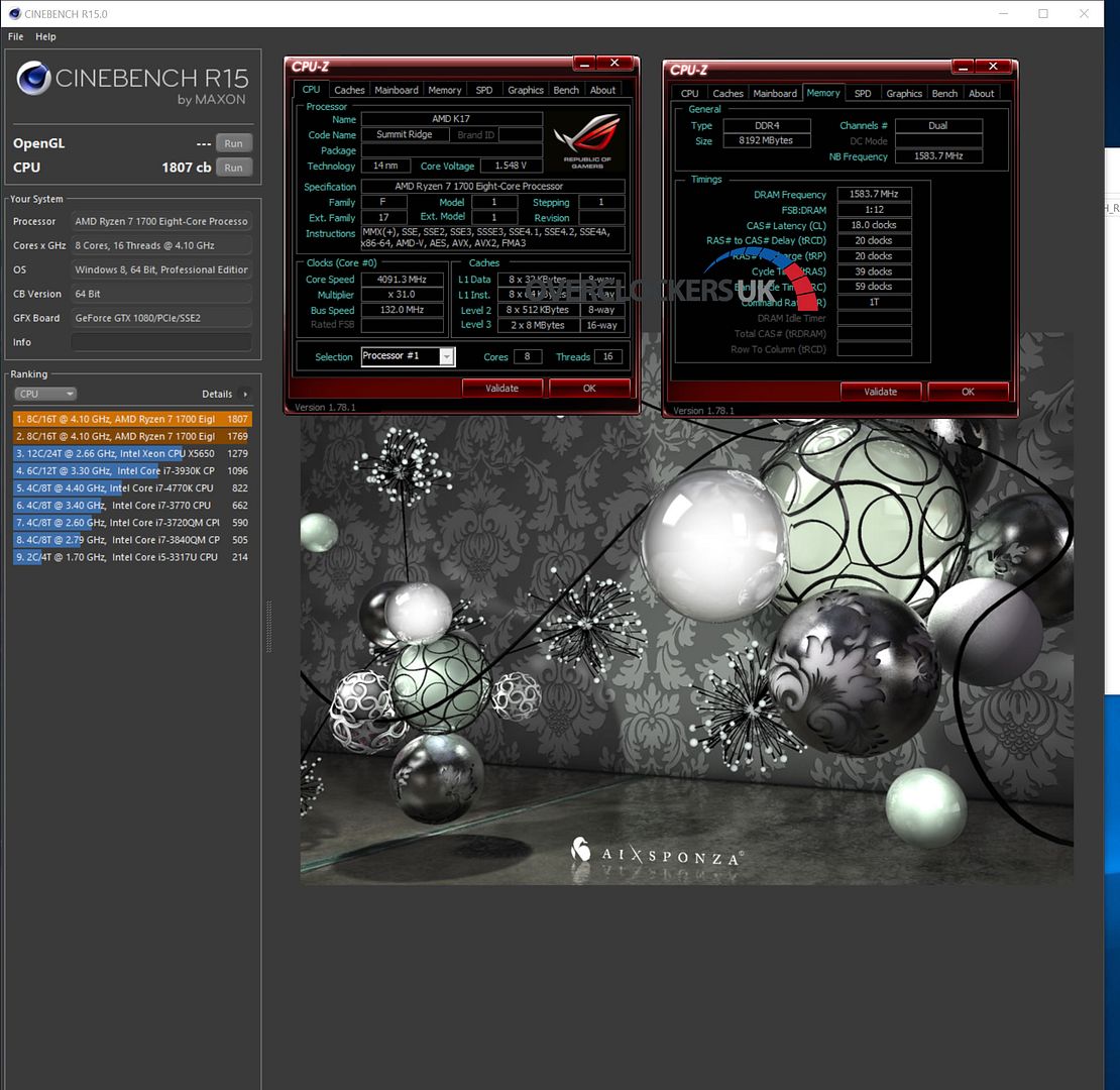

So I grabbed a retail processor to see how well it did compared to the retail sample AMD provided me. The sample was rock stable in everything at 4050MHz, but anything higher could be flaky.
Glad to report the retail CPU was rock stable at 4100MHz even with the memory running as high as 3200MHz.

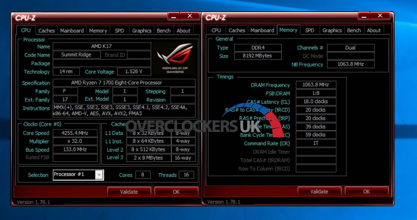

Sacrificing memory performance could yield 4.25GHz, but we found running the memory at 3000-3200MHz yielded a greater gain than running the CPU at 4.2GHz with RAM at 2400MHz.
As such sweet spot is memory at 3000MHz C16, however getting memory to run at high clocks takes a lot of trial and error and he had good results with enabling DOCP profiles and then clocking down.
Some screenshots of the 1700:
gib3.jpg~original
gib1.jpg~original
gib2.jpg~original
I personally think it is a fantastic achievement from AMD, this 65W 3.0GHz base chip is rock stable at 1100MHz above its rated speed.
The 1700 does have XFR but its boost is limited to stay within the 65W specification, but once you switch to manual overclocking the 1700 is no different to the 1700X or 1800X and can easily run at 1800X speeds when overclocked.
