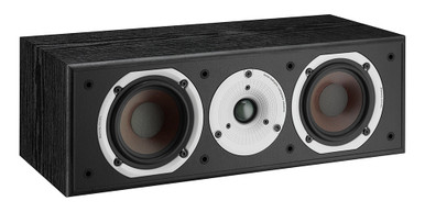

Look at your AV settings and consider buying a centre speaker to go with your two Dali Spektors.

Most of the dialogue comes through the centre speaker, so if you haven’t got one no wonder you can’t hear anything. Don’t waste money on a soundbar just get a center speaker

The one I linked above isn't too large and shouldn't take up more room than a soundbar at £99, although there are smaller options available.
With a centre speaker the AVR will send voice to it rather than mixing it between the two sides, so it should help with your problem and open up more options for setting up your AVR.
Buy the matching center that'll allow you to set center channel level, and adjust dialogue enhance, download your manual and look for dialogue enhance. It'll be an option once you add a center.

That’s great, thanks! I do like the idea of sticking with Dali. I’d never looked into centre speaker, but seems to make a lot of sense if dialogue comes through there nice and clear rather than mixed with the sides.
For anyone who cares, I’ve ordered the Dali Spector vokal from Peter Tyson… as richer sounds never did call me back.
Few new banana plugs too and some nice new cable to re-wire it all.
Oh and a wee floating shelf to put the speaker on. Will see what it’s like in the coming days
Got it hooked up a week or two ago now, it has made a difference... feel like im not turning the sound up so much. So im not getting that annoying loud music and explosions then quiet talking.
Voice is much clearer, I can feel the position of the voices come from the centre speaker, so it does seem to be filling in a gap or doing better than the bookshelf ones were doing.
