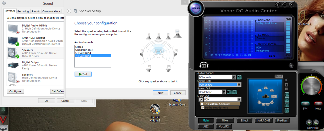

Finally got my qh-90's and I am really quite impressed with them, still messing with settings atm. Are this recommended or should I try different settings? Can't seem to get magic voice working though even if I add the .exe to the app list.
When you get the DGX have a play with the Dolby Headphone feature. It improves positional audio immensely by transforming it to a HRTF / binaural audio signal.
Creative uses the same concept with its CMSS-3D and SBX surround.
For games that don't allow you to configure surround sound as an option set your speakers in the windows mixer to 5.1/7.1 then enable Dolby Headphone.
I was sceptical when I first tried using it but the results are actually quite impressive.
