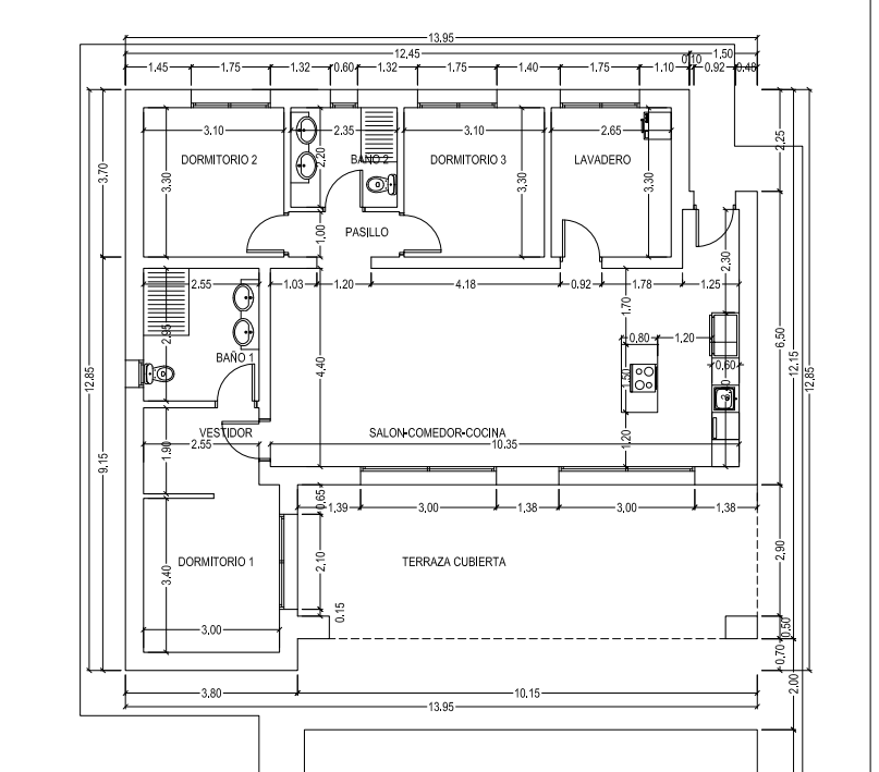

For some following my thread elsewhere may have seen we're about to build a house over here in Spain. The plot is going to be pretty rural with loads of views of the mountains, and so an open plan, build with decent window views is the main plan.
After chats with a local developer, we decided on this build. He had around 6 "standard" house models and this fit our needs in terms of size/cost/layout. However we added the laundry to the top right, and switched the front door from where it is in this picture to the back of the house as seen on the floorplan
We were really happy with this, but now it's getting to the crunch time of signing the forms we're having some doubts.
Main concerns
1) Due to the large windows in the front room/kitchen, it doesn't offer a suitable location for a pellet burner. I like the idea of it on the wall inbetween the 2 windows, but my wife wants it in the top left corner alongside the TV. To me this cramps loads of things into one corner of a big room, but i can see the appeal of being snuggly on a sofa watching fire
2) The door to bedrooms 2/3 is in the middle of the seating area. Dormitorio 2 is going to be my office. This means that every time i want a drink/general skive, i'm going to be walking in front of my wife on the sofa. It also puts the sofa miles from the TV
The above are pretty much it for our "issues" with the plan and they both stem from the same thing.
Possible thoughts/changes
Replace the left patio door with a wall up to midway and then have a 1.5 / double sized bifold door on the kitchen side. This creates extra wall space, the tv could then go on this wall if needed with the sofa backing to the bedroom entrances
Steal a bit from bedroom 3, put the entrance to the bedroom "Pasillo" where the bedroom 3 door is
Put the kitchen units along the right side wall. This opens up loads of wall space. In fact he sent me a floorplan suggestion with exactly this
Other Notes to make
We like the bedroom 2/3 separate from the main bedroom, some layouts put them all in a row, but we like them separated.
We're unlikely to have a dining table as per the top floorplan. We'll have a nice outdoor table on the terrace and otherwise will eat at the island/sofa. A table just annoys the wife as i use it as a dumping group for stuff!
The general dimensions of the above layout work for us, we want single floor living and nothing too big as it's only the 2 of us. I'll also be adding a ~50m2 garage as a home gym/music room
The exterior of the house isn't 100% to our tastes, it's very possible that we finish it like this
So to you lovely lot. What changes would you make if you had the choice with no restrictions? Also what's the best/easiest floorplan/rendering tool i can have a play around with?
Plan 1 take away the bit of sofa against the wall and mirror it on the other side of the sofa.
This gives you a walk way to the kitchen or use a smaller sofa
on plan 1 you have loads of space in front of island and along wall. whats your plans there as its all hugging back wall.
Good point, however i'm not sure the room width gives enough space to move the corner bit of the sofa to the other side without limiting walking room in front of the double doors
Not too sure, i think with the island we'd likely make it considerably longer so it's 2 long rows of cabinets, then on the right wall will likely be a cabinet with a picture above it. Mainly because it's about the only place we can think to put the picture there!
The other plan would be to go with plan 2, but shift the window along so we can utilise the bottom wall into a U shaped kitchen, this potentially helps move the cabinets further down away from the front door to avoid the entrance being cramped. I would love to try and squeeze front doors like this into the build, just not sure if it fits anywhere

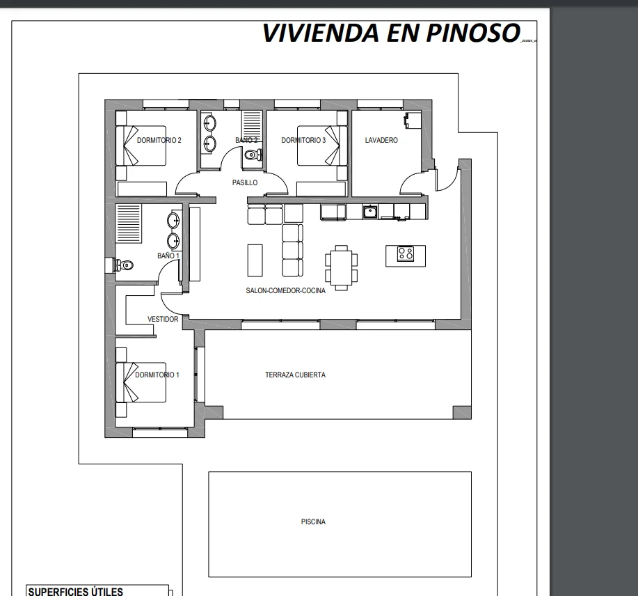

In his revised plan this is what I would consider to change.
lavadero door location back to original position.
Lol I had to Google lavadero.
Keep sink and units along back wall.
loose island with hob and relocate hob and units if required on lavadero wall this will create space for a table
Put a pellet burner that your wife wants going bang central of the room with flue going straight . Basically a beautiful fireplace centrally heating the whole area .
Furniture and TV as originally planned.

On plan 1 can't you swap the kitchen area and the seating area?
Have a straight long sofa or chaise lounge sofa instead of a corner.
No real issues other than why is the lavadero so big? Could some of the width go to bedrooms 2 and 3? Is it just for symmetry of the windows?
We probably could. I just need to try and remember why my wife didn't want to!
It was actually a choice by us to have it big. By the time you have a washing machine, boiler, wine rack (essential!), server rack with battery storage and shelves for bulk purchases i don't think there's really much room left. We also had an american fridge in the utility room back in England and quite liked it being out of the way.

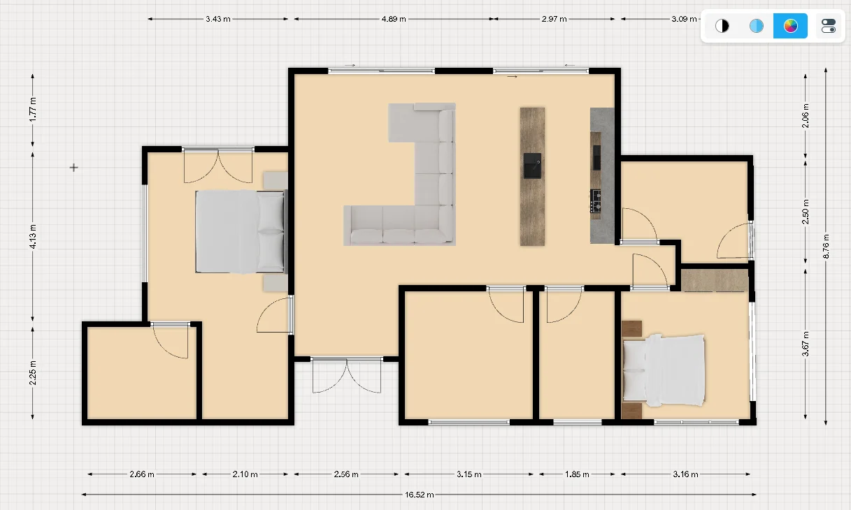

So, was up until around midnight last night playing with floorplan ideas, and i think i quite like this
It makes the master suite pretty big, with walk in wardrobe section
The seating area faces a big wall for the TV
It has a decent entrance hallway
Nice recessed bit outside the main bedroom for a small seating area
Great views from the main bedroom
Laundry is pretty big, with an external door for that end of the house
Main bathroom is open to all, rather than being focussed towards bedrooms 2/3
It takes the above plan and adds around 5m2 of floorspace but that shouldn't add *too* much cost to make it unaffordable
With open plan kitchen/living areas you need really really good cooker extraction to the outside.
Otherwise all your soft furnishings start to smell of food!
Really like the overall feel though.
