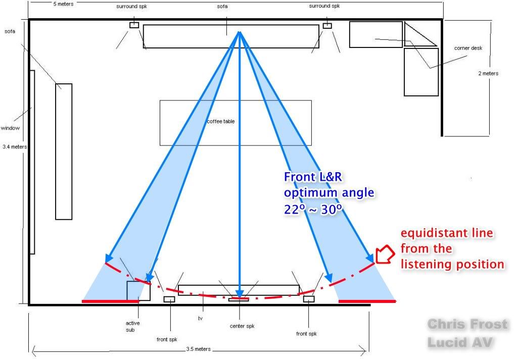

pardon my seriously lacking paint skills but this is a digram of our living room.
As you can see our downstairs floor is basically open plan so there is a huge open corner in the room.
I am having a bit of trouble properly locating the surround speakers. in a Normal room I would just put them in the corners but that would make them uneven in this room.
As they are now they are overpowering because we are so close to them which in surround situations tends to push the sound behind us.
Our amp lets us specify how far away from the listenting position the speakers are placed but the lowest setting is 1 meter and it does not let us do the surrounds seperate.
To further complicate it the window is a big bay window that takes up nearly the entire wall on that side.
The amp also lets us specify if the surrounds are low or high so I was thinking of going higher on the wall and spreading them a bit to get at least a meter away but if I do that will it send the sound over our heads?
Anyway any input you guys can give on a good place to put the surrounds would be helpful.
Also please keep in mind that re-arranging the furniture is not an option
because the other side of the room is a window :)
and if I put them further back so they are right beside the sofa then they would but off center by nearly a full meter because of the placement of the sofa which would adversly affect the surround
thats a good point I do have tilt and swivel mounts that came with them so i'll try a higher position with some tilt.
I have just looked at a speaker placement guide on the dolby site and they recomend a listening angle between 90 and 110 degrees on the surrounds on 5.1.
Higher, spread and tilted should fall within that range so i'll try that.
ok thanks for the advice guys.
I have moved them so that they are 1.7 meters off the floor, 1.5 meters from the center of the sofa.
Using the tilt and swivel wall mounts that came with them I have swiveled them inwards so they face at the sofa and tilted them down so they point directly at the center of the sofa.
A quick test with Star Trek nemesis shows you can't really tell they are there during normal dialouge but when the surround stuff kicks in they are definataly doing thier job giving clean motion to the sound and they seem pretty well balanced out.
my pics is not realy to scale as I am horrible with paint but using the tv center as the center point that would put my fronts right in the blue arc you have given there so thier placement is fine.
And with the the rears mounted the way they are now and swiveled to point at the sofa center point it actualy puts them on a 100 degree listeneing angle which according to the dolby site is bang on what they should be.
