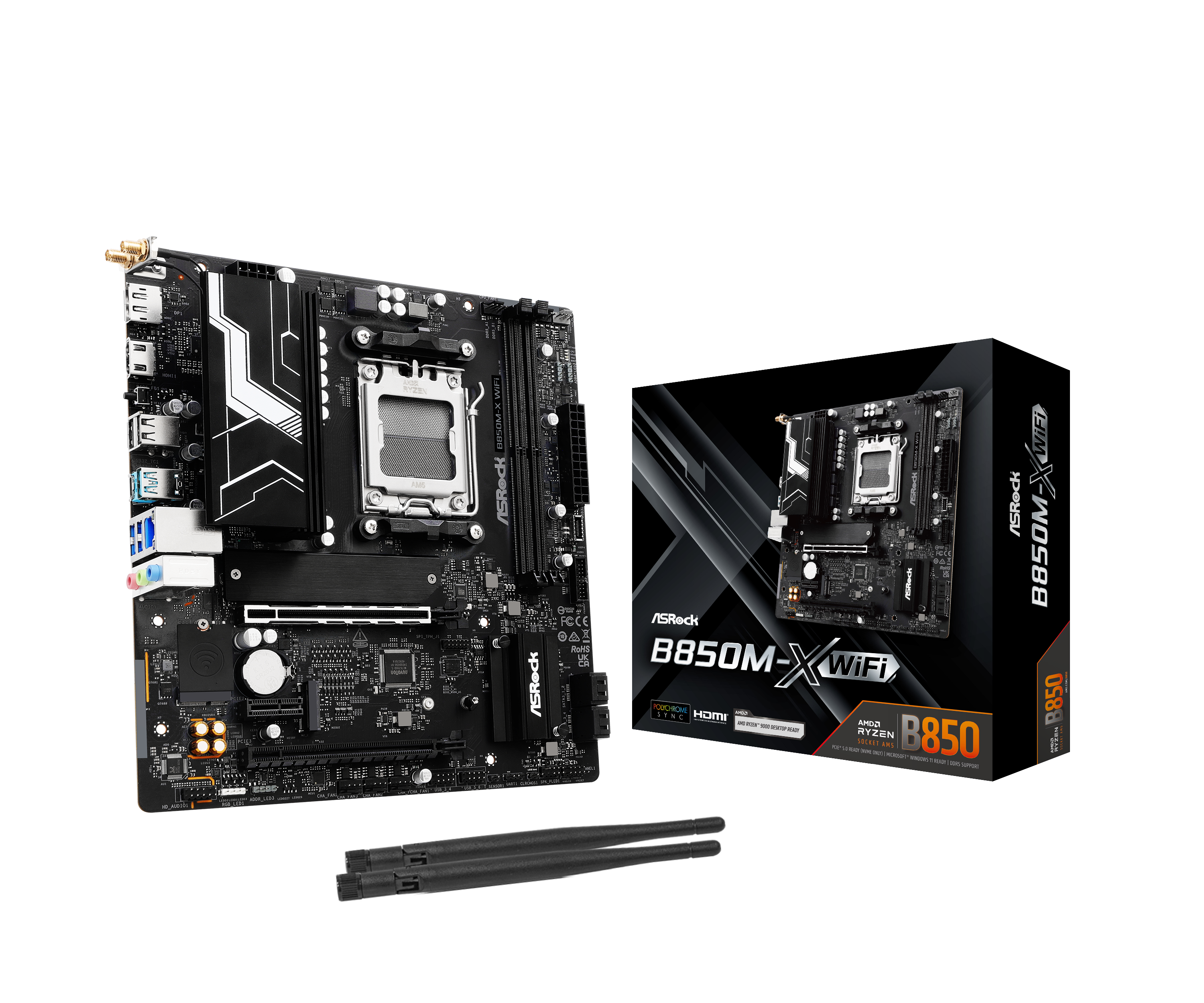

Hi, any feedback on the build spec below ? Probably overkill, but want it to last a while (5 years plus). Replacing an old i5 6th Gen machine before Win 10 goes end of support. Use case is web browsing, spreadsheets, Youtube (no gaming). He wanted a smaller case, hence the choice, but never done a smaller build before.

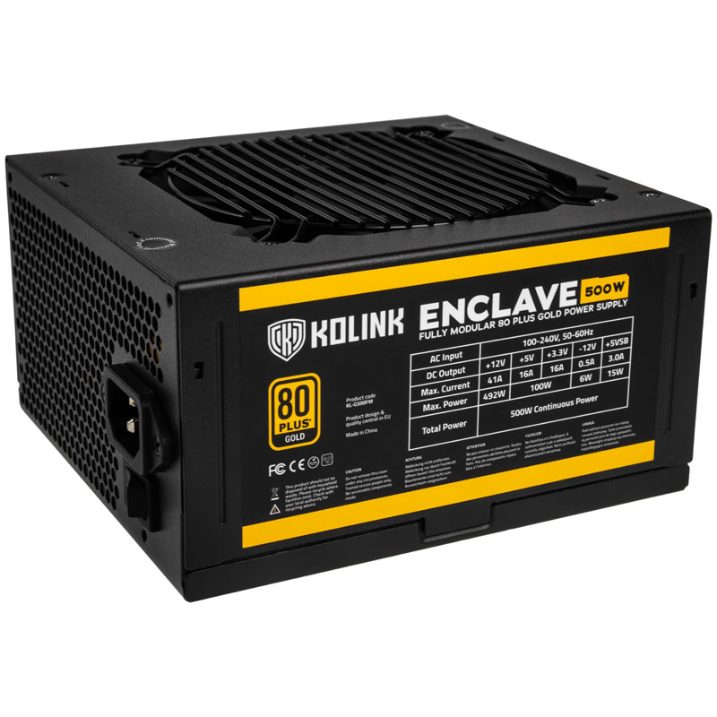

PSU: this is expensive for the budget, but it has an 8 year warranty, an extended passive mode and can support the latest graphics cards (..you never know).
Motherboard: it has PCI-E 5.0 (not that important in this case, especially since the 8500G doesn't support it) and 2x DP and 1x HDMI (not sure if multiple screens is an issue here).

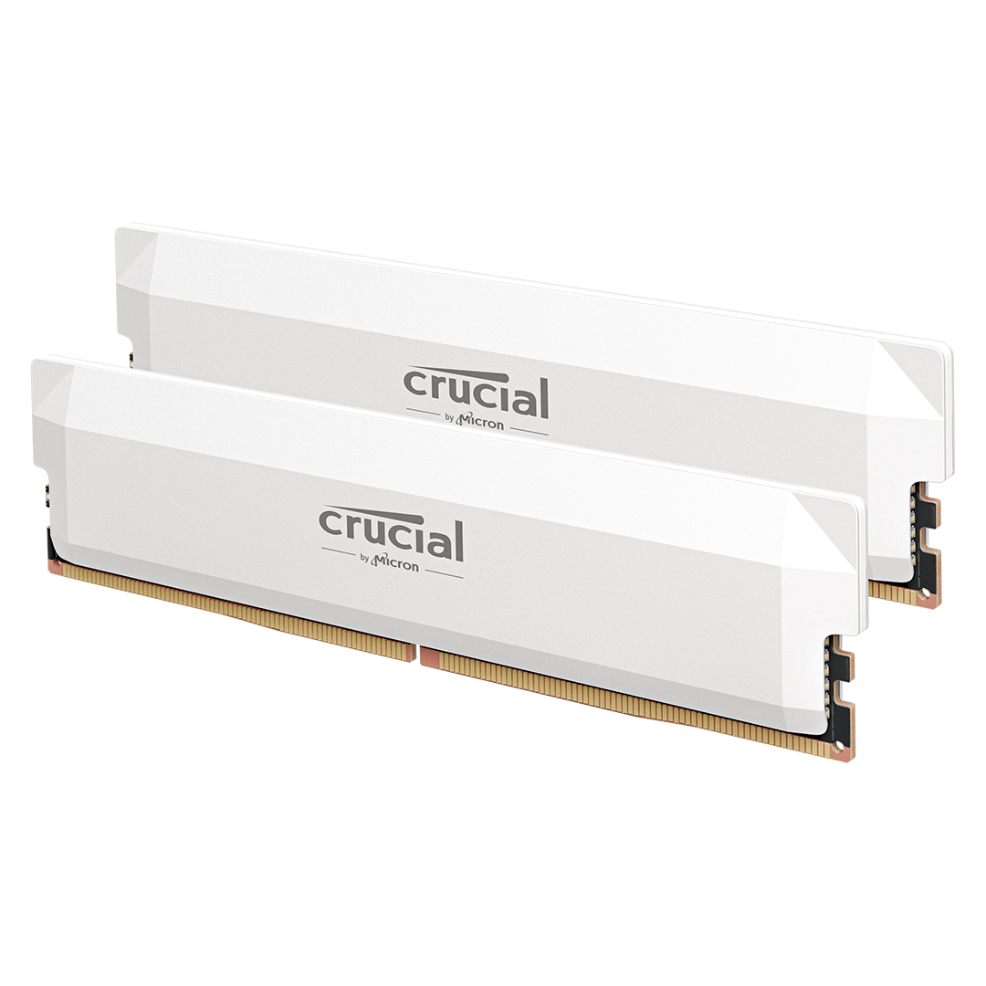

Memory: for this kind of usage I'd expect the memory speed won't matter at all, so I went for capacity instead. These sticks are also JEDEC spec, so don't even need to set XMP/EXPO in the BIOS.
