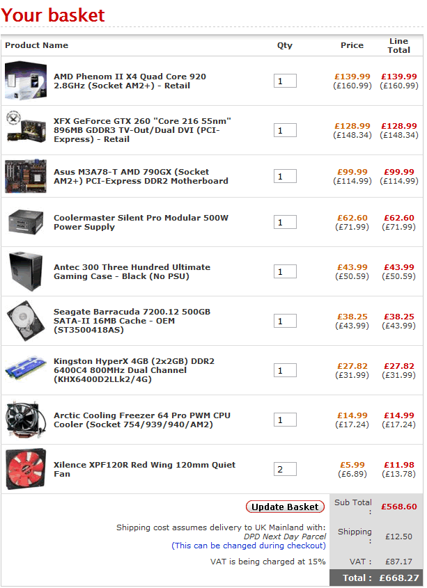

As per title :)
It's for a friend and he's using a 1680x1050 monitor and wants a decent machine at a reasonable price. This is what I came up with but if there's anything that I could/should change then please enlighten!
It's not likely to be overclocked either. Already have an OS and optical drive.
Pretty much 100% for gaming, yea. How much difference are we talking about between the Q6700 and the Phenom 2?
What does the Phenom 2 do better in than the Q6700?
Not much, maybe 5% or so at stock settings but clock for clock it is faster. In pretty much everything else they will perform basically the same.
I just thought you could save £50 while getting slightly better performance. Could be put towards a faster graphics card, bigger HD etc.
I like that thinking :D I wouldn't get much benefit for an extra £50 on a graphics card, would I?
