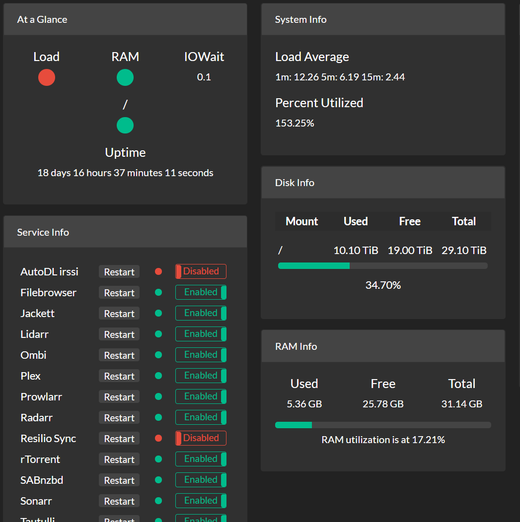

Here's my current server stats / usage (don't know if this is useful) it's dedicated not virtual
Have you looked at ram usage when it's under heavier load. Using less than a quarter of ram, a third of the storage is going to be rather expensive.
Funny you mention, I have never seen the ram usage spike ever, it's fairly consistent.
Here's it's transcoding a 4k movie, it's around 60Gb
ram
