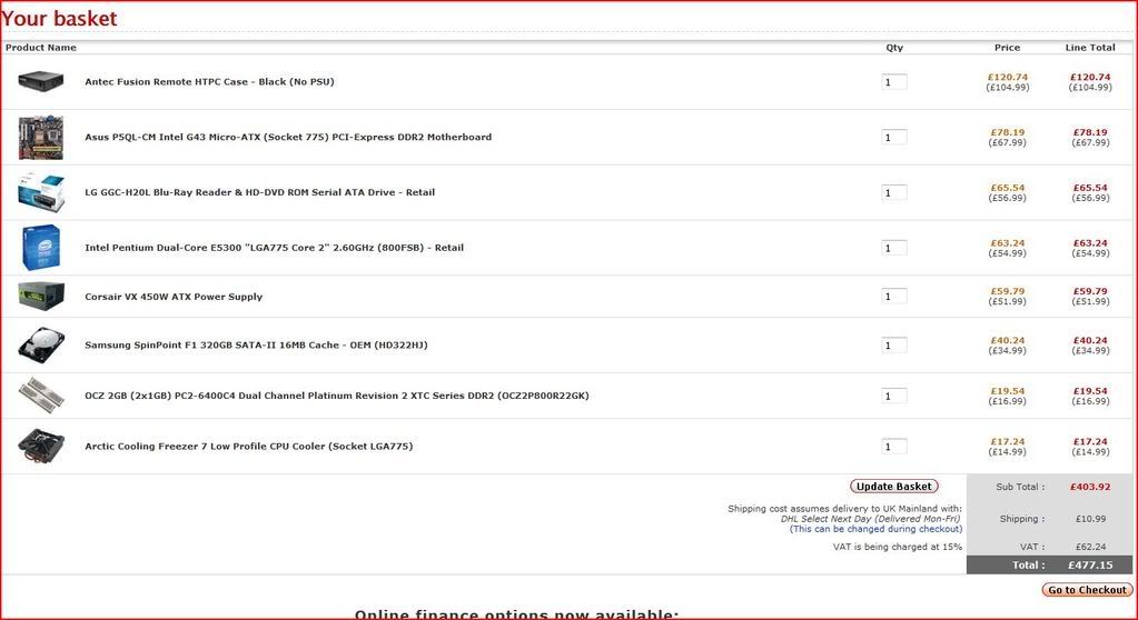

How does this look?
Also how can i use a remote for this and where can i find what i need?
Is that graphics card and overkill?
What psu should i use?
Any reason for not going for a blu-ray drive (your system is quite capable)
A remote comes with the case & should be compatible with some of the software used for media playback
Corsair VX450 should be more than capable.
Graphics is fine.
its really too much now, any ideas to lowering the price. at the moment here is how it stands.
when i add the monitor its £650!!! AHHHHHH!
also do i need a 1920 x1080 monitor to run bluray or can a smaller one with dvi scale it down.
You are on a budget forget gaming.
You can then get a 2nd hand 32" Hd lcd from the rainforest for around £300. Anything smaller and HD is more or less pointless.
Tim I'd advise you to consider Athlon 6000, same price and 3.10 ghz ! Also you forgot to out an optical in. I'm not sure if integrated graphics would be up to job of Blu ray. BR probably won't even look very good on a 22" value monitor! Just save some and maybe spend on gpu so you can do a bit of gaming, that 4550 looks pretty good!
