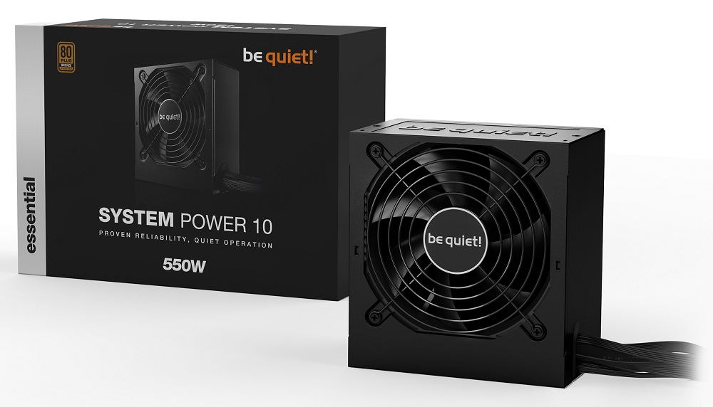

i can't find a picture of that case, but i would suspect it doesn't have any usb 3 ports and that psu needs replacing

Yeah., PSU is 10 years old so probably makes sense to replace that now. In fact probably a bad idea to keep the case as it was only a cheap one at the time (26 quid) and its had its day I reckon

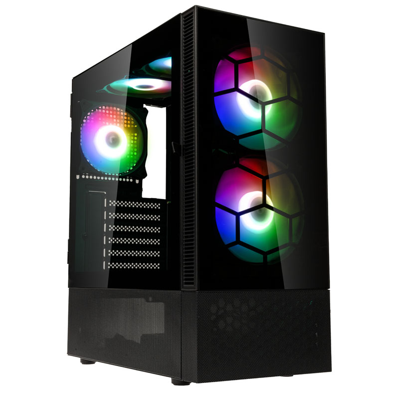

the case is a bit of a meh (too expensive), ideally would want to spend less, however the cheaper MATX-sized cases stocked at OCUK are terrible

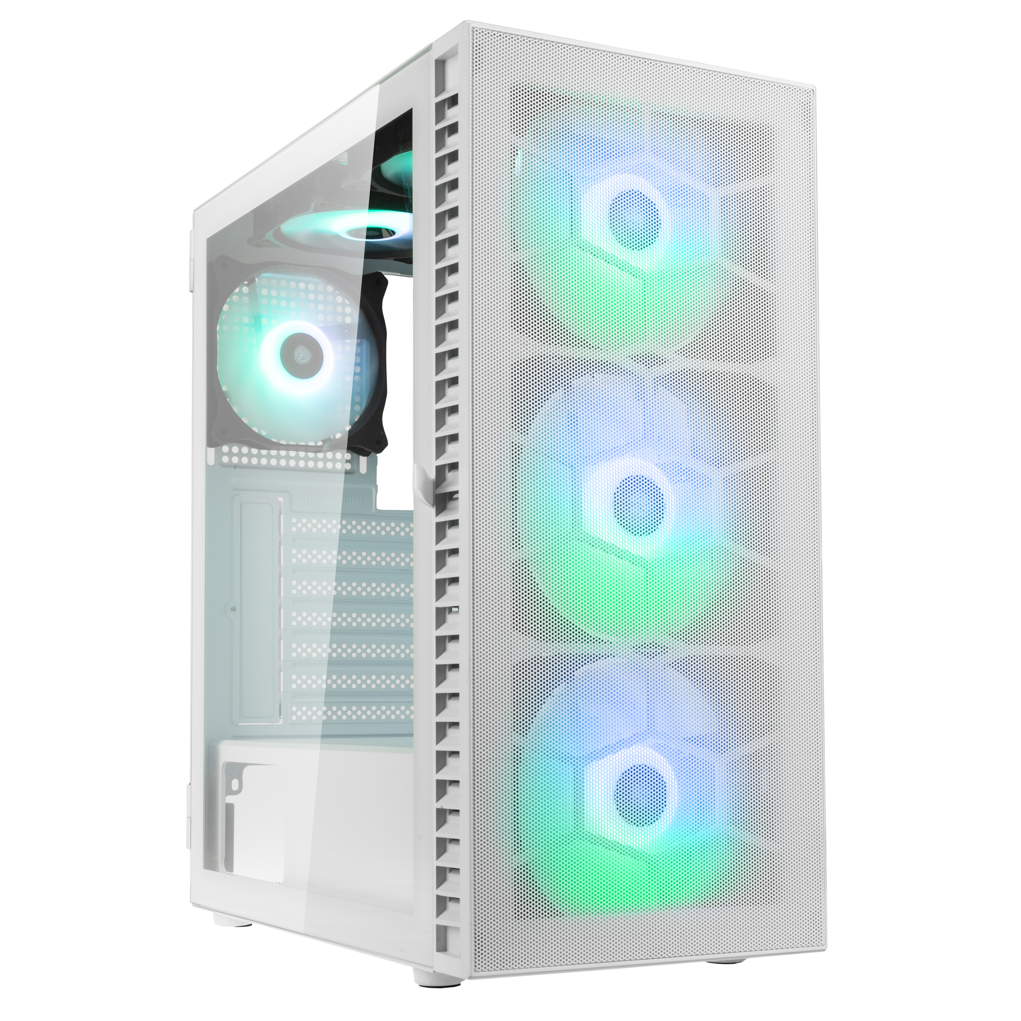

if you don't mind having a big case for a small system then this would be my recommendation: https://www.overclockers.co.uk/kolink-observatory-hf-mesh-argb-midi-tower-case-white-ca-07t-kk.html
for £32 it's a great case and i've just built in one last week, so first-hand recommendation. it also comes with 6 RGB fans (can turn off the RGB if you don't want them on)
Thanks! I'll have a look at the 2 cases - not too bothered about the tenner price difference either way.

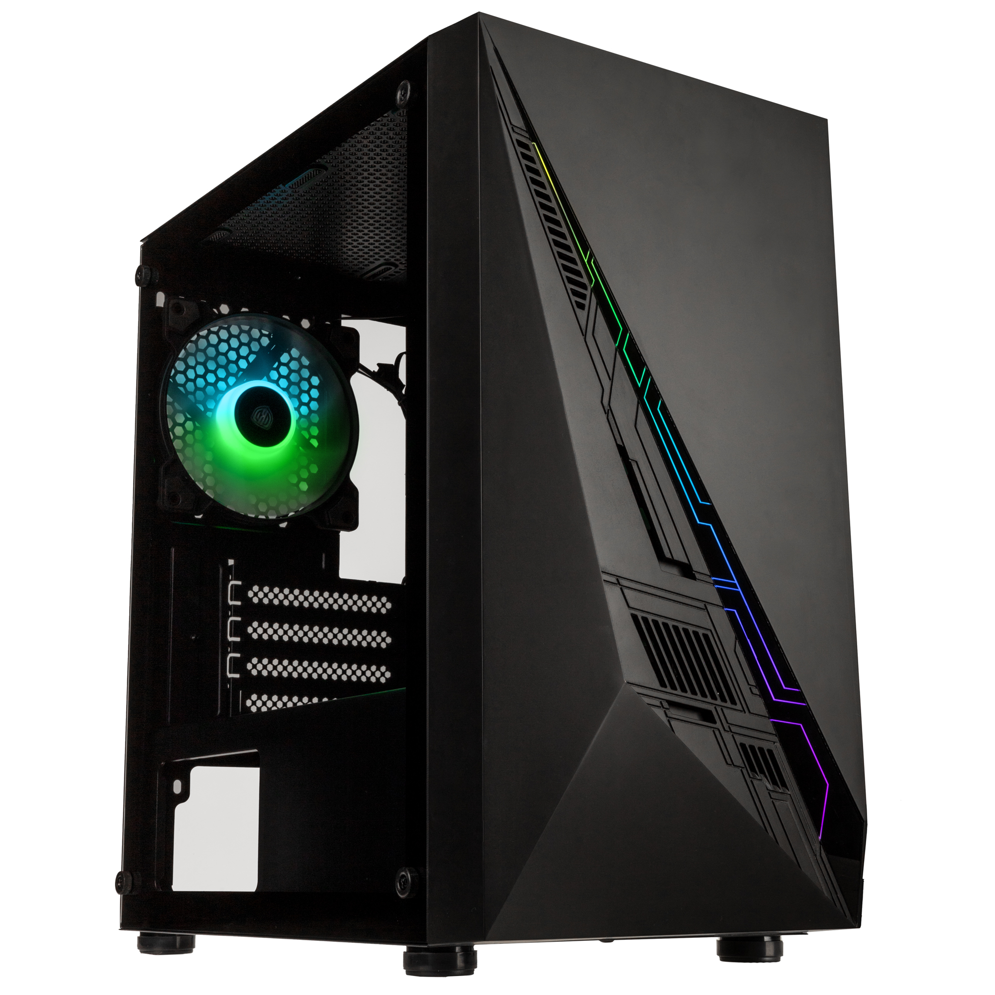

1 x Kolink Inspire Series K2 Plus ARGB Micro-ATX Case - Black Window (SKU: CA-07B-KK) = £42.95
