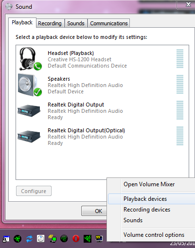

The one way I know of to get this to work is to use a USB Headset and to be using win7 (not sure about vista).
You then right click on the volume icon and select playback devices and set the headset as the default communications device (if it hasn't already been set as that after install of the headset drivers).
You can also set the headset as the default device to make it so all the PC sounds go through the headset only.
