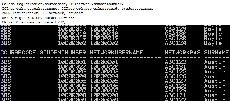

I'm trying to query a database where there are 20 "registered students".
However the output as a snippet below shows, is 1200 in size!
I'm sure it is a basic error, but would one of you be able to help!
Thanks!
edit: each surname seems to be repeated 60?

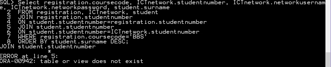

Line5: "JOIN student.studentnumber"
should be: "JOIN Student"
Is ICTnetwork.studentnumber a real field? I was just guessing so you might need to change that part as well.

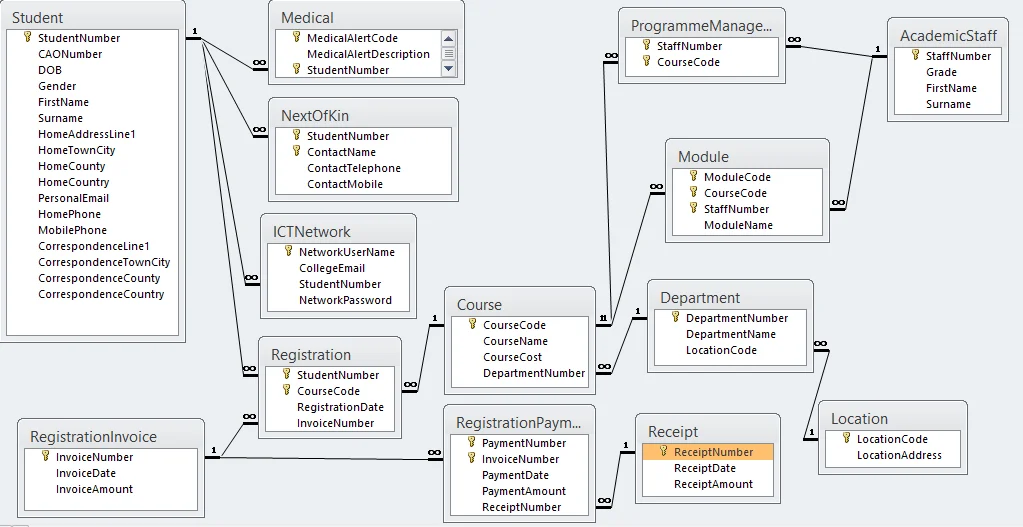

P.s here is a visual representation of everything.
edit: even changing it to student or studentnumber, doesn't work, it gives the same error.

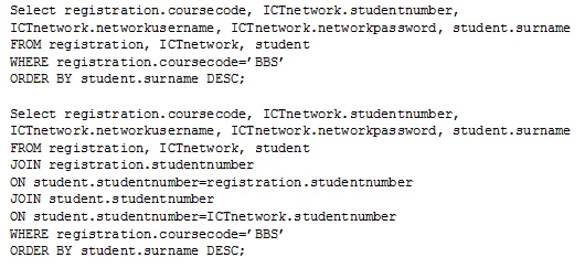

At the moment, you are trying to select from the 3 tables and then also perform 2 joins on non-existant tables. Remove the tables you are joining to from the "FROM" clause and then sort out the joins by referencing the table and not the field. EG:
Code:
FROM
  ICTNetwork
  JOIN student ON student.studentnumber = ICTnetwork.studentnumber
  JOIN registration ON registration.studentnumber = student.studentnumber
The join you had on "registration.studentnumber" would typically mean a database/schema called "registration" and then a table called "studentnumber".
The way you had it setup originally when all 3 tables were in the "FROM" clause would usually be called a "cross join" which means join all rows in one table to all rows in another and generates something called a Cartesian Product.
I tried that, but it now says:
ERROR at line 6:
ORA-00904: "STUDENTNUMBER"."ICTNETWORK": invalid identifier
Do you have a table called "studentnumber"?
You might want to post the whole query as there was no mention of "studentnumber.ictnetwork" in the bit I posted.

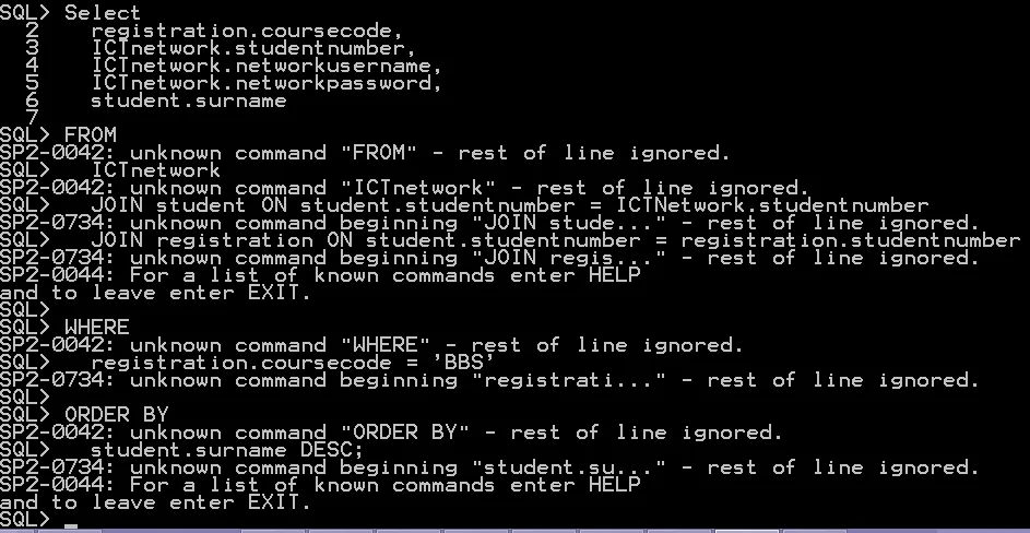

But when I got rid of the spacings it worked perfectly! SQL is a strange beast! (using SQLplus with oracle express developer).
You're a saint! I really really appreciate you giving me the help on a Sunday afternoon. Got 6 more queries to do for my "homework", and will be having a test on it in the next two days! (if you're around, and can help with some queries, you're more than welcome to my steam pass that I've currently got for same in the Members market).
SQLplus is a command line interface which will treat the carriage returns as an execute instruction. If you use a GUI such as SQL Developer (free) you can paste in a whole formatted block and it will be fine.
SQL developer? Going to have to find that! Thanks! :)
