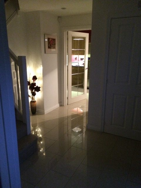

I've 60x30cm in a brick pattern in my kitchen/diner/hall/utility.

looks really professional and well finished to my untrained eye, but rectangle tiles always trigger the OCD in me.
all the different lengths along the walls just hate it.
more annoying is when its those small rectangle tiles on someones bathroom wall, in a brick pattern.
reminds me of public toilets in the 90s, the council owned ones that used to exist around town centres
