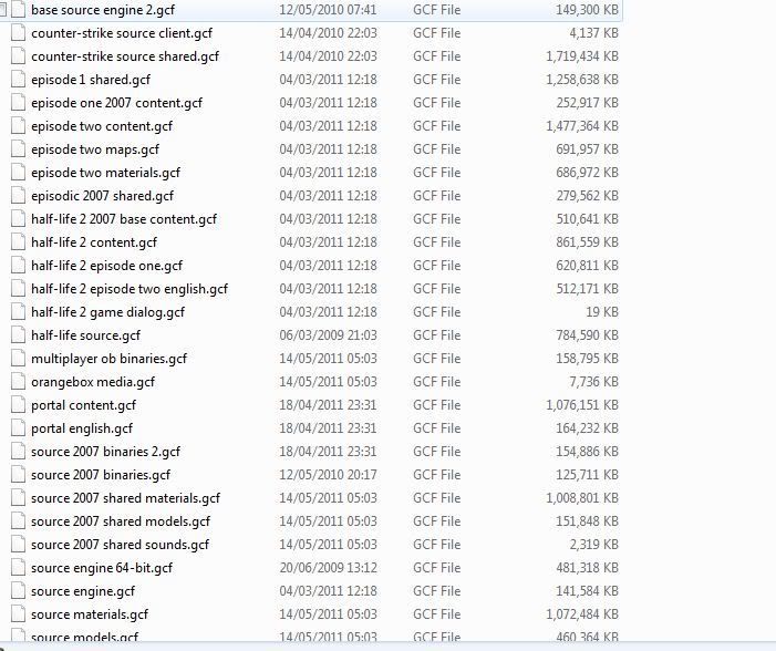

You copy the folder of the game in question, but if it's a valve game there will be a few .gcf files in the steamapps folder that you need to copy too.
Note the size of some of the files here.
