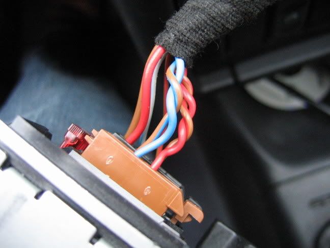

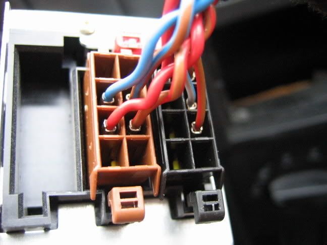

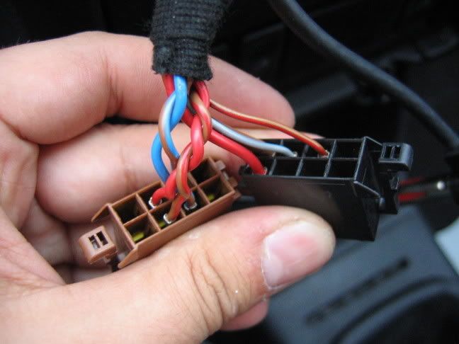

Right I've had the radio out and there are no red or yellow wires :(
All I seem to have is red, brown and blue wires.

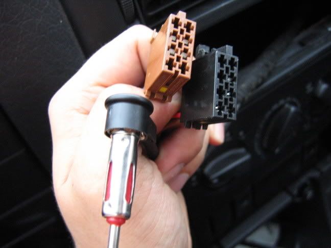

or do I need to use an iso converter?
The reason I ask is because I don't have the yellow/red wires you describe, but the cable from the radio already fits and powers it.
IIRC certain VW's have use an extra live, I cant remember which one exactly or what models did have but I recently used a VW radio harness in my car and had to cut it out. I once used a VW radio in my old car when mine was stolen and had to wire an extra live in to get that working too.
Hmmm, i wouldnt mess with them, if you really need them storing, get an autoleads ISO adaptor,in your case it will just act as an extension lead, but will enable you to switch the wires around.
